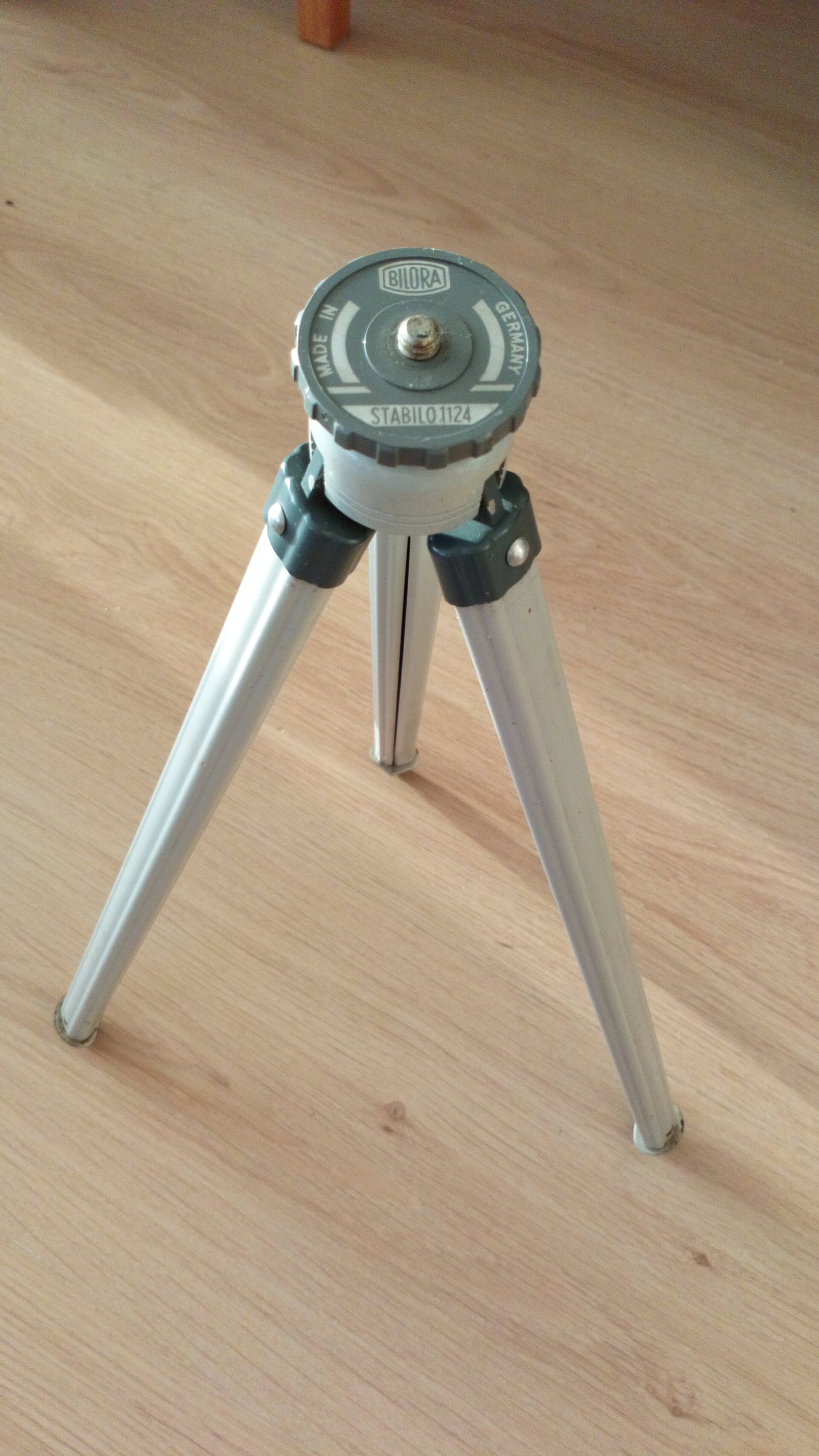

- My most used tripod is an extremely simple one like this one.
I use it for folders and small 135. For that it is quite adequate.
On grass or earth I can spread out the legs to get it low and stabile very quickly.
There is no stupid locks or catches that impede the use. Either leg swings freely.
For indoor use I can use it with a hand near it at all times, should a person or pet get near.

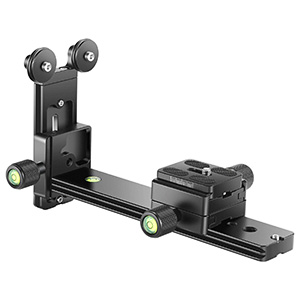

With a longer lens on a MF camera, a cradle like this comes in handy when using a high-quality, heavy-duty ballhead with a quick-release:
Also, I usually frame the image hand-held first and then put up the tripod at the appropriate height for the shot.
With the 500mm lens on the Hasselblad it use the lens's tripod mount and the camera which is much lighter hands on the end.
