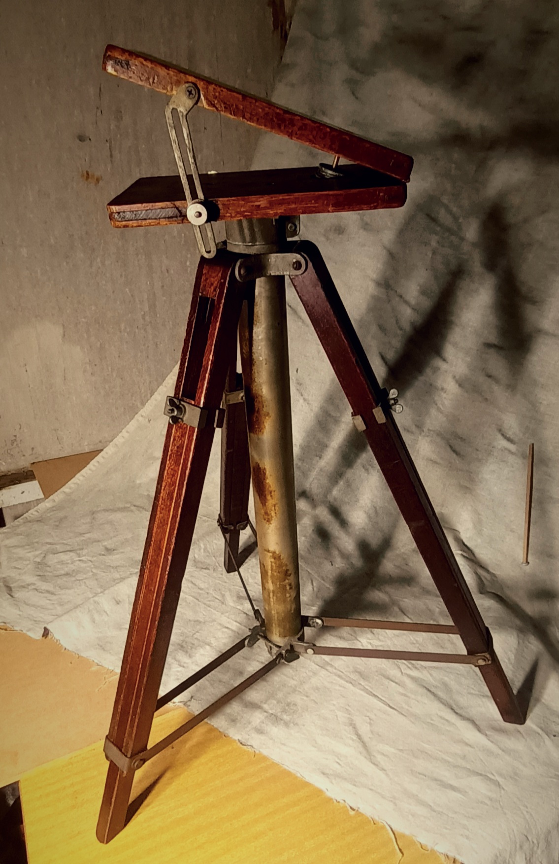

I also have two old (1920s or 1930s, I reckon) Kodak-type tripods with Leitz heads. These can easy support the weight of my heavier Nikon DSLRs or my Rolleis on the rare occasion I still take architectural images that require a "stand" of some sort. I have somewhere in the house, a sack-like setup I can hang from the bottom of one of these two relics (the tripods, not the photographer), but I can't recall the last time I made use of this odd thing. Or the tripods, for that matter.

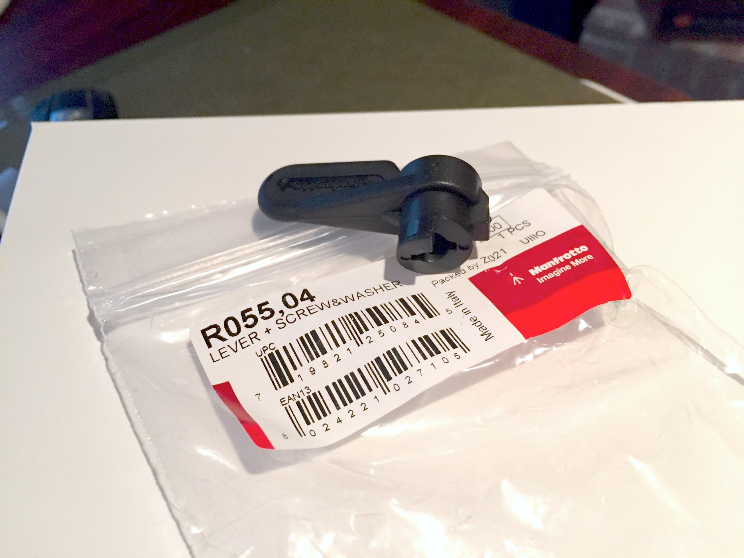

Don't forget tripod maintenance. I have had my main tripod for 8x10 since 1989 and did a complete overhaul a few years ago. I replaced all the nylon lock nuts, got a new lever that was broken. I replaced the broken bubble level on the base (found one from China that fit perfectly) tightened the head and other loose screws, etc. Big improvement. Zeroed the bubble levels (non broken after all these years!) on the head plate. All legs lock as they should and the head is steadier and locks better.
I carry Allen wrenches for mine.
