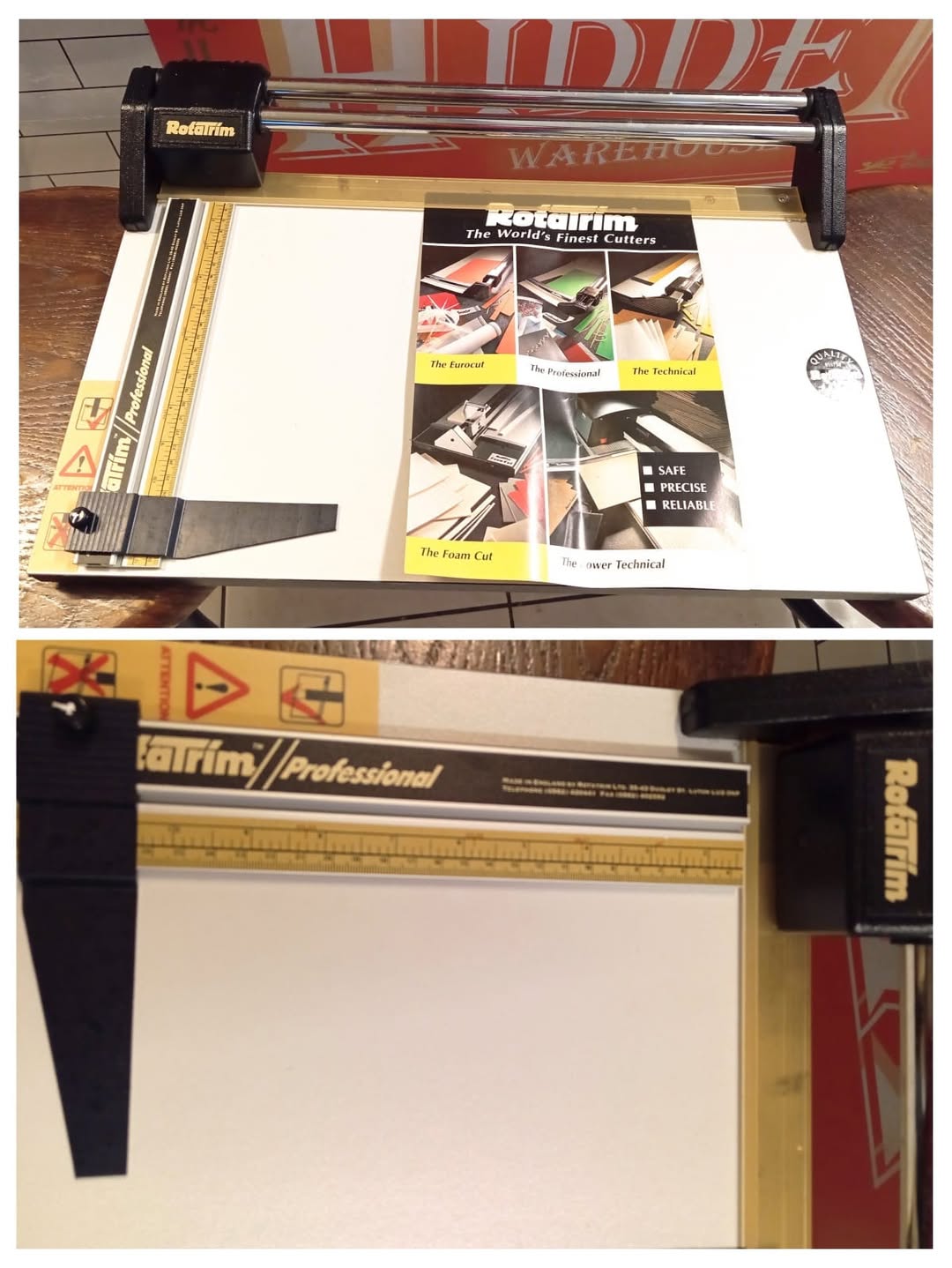

It is actually Rotatrim, but I agree with the recommendation for quality and ease of use and I expect durability.
Dahle is best known for their guillotine cutters; but there are different quality levels of those. With Rotatrim, which is safer, get the dual rail model. (It's hard not to misspell it "Roto" - this is rotary trimmer season, buzzing the outdoor weeds down). I've been using both.
Rototrim.
I've used the larger Rototrim pros and so long as you're not cutting mat board, or multi sheets at one time, your golden, IMO.
Just be careful from hour one, to handle it correctly and store it as directed.
Brilliant cutters....& as Eli said....not for mat board.
I've got a 24" in my darkroom

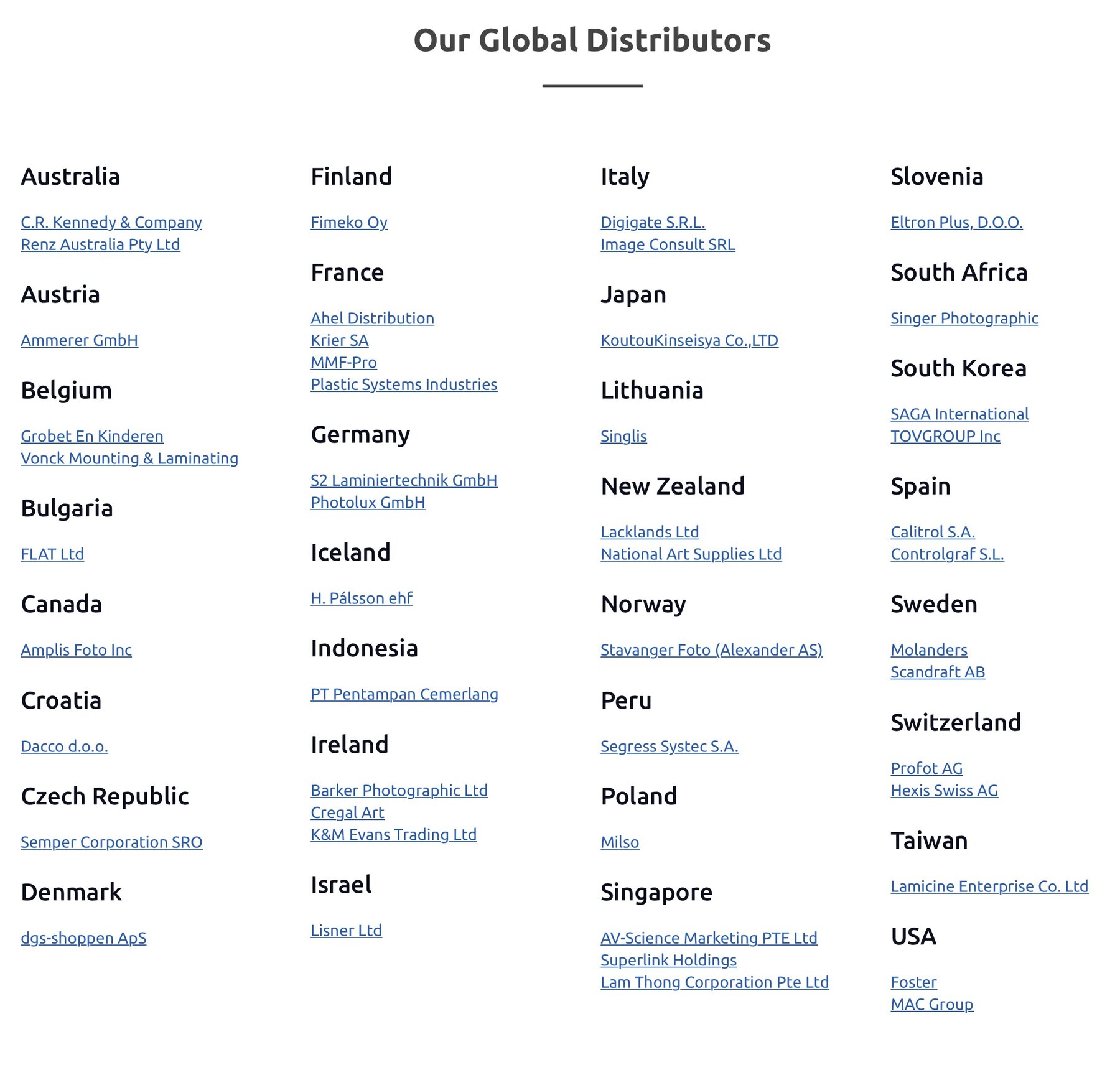

The people suggesting Rotatrim probably don't realize that the brand is virtually nonexistent on the European market. If you buy a Rotatrim in the US or Canada, you buy a Dahle in Europe.
Dahle rotary trimmers; select a version that suits your needs: https://www.dahle.com/trimmers/rotary
The main drawback of most rotary trimmers is that the bed is fairly short. If you want stops that give you more length than the bed can accommodate, you can make an extension to the bed from plywood or any other suitable material, and place your stops on there. Magnets work nicely for this.
Sorry, but Rotatrim is a British company.
I'm in mainland EU. If I shop here for a rotary cutter or another type of paper cutter, Rotatrim is either not on the list, or very far down, or only available trough specialty outlets. On the local equivalents of e.g. Amazon, Dahle is readily available, as they are in virtually every other retail outlet (online or brick & mortar).
I know that Rotatrim is well available in the US as I see them referenced all the time. I just pointed out that local availability varies across the globe. I don't know where their HQ is or where their products are manufactured, and IMO it's not really relevant for what I indicated. OP specifically asked for options readily available in the EU; that's what I commented on.
Rotatrim is a British company and their products are made there. Here is a list of global distributors... https://rotatrim.com/distributor
It is very possible that the Rotatrim distributors in the EU are concentrating on the commercial market, and don't have many/any customers who sell into the retail market.
It is a bit of a chicken and egg situation. If they started selling to regular commercial retailers, that segment of the market might come to expect them.
To give you an example that is really different, but I think explanatory, I used to buy D&F photo album materials from a wholesaler when I had a photography business. D&F only sold those products through wholesalers to professional photographers who operated a business. They did not make them available to the retail market. The situation in the EU for Rotatrim may have some similarities.
The differences in local markets are sometimes confounding.
Rotatrim: https://rotatrim.com/shop/technical-t-series/trimmers-technical-t-series/technical-t1250
Being part of the european market, in my country I could by Rotatrim products from Monochrom, from Photolux or from Kamera Express.
Comparing Rotatrim's Technical T series or the Digital T series with Dahle https://www.dahle.com/trimmer/item/448, Dahle products look flimsy. Plastic overall.
DT series are cutting up to 2mm, TT series are cutting up to 4mm.
