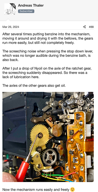

Simply dip it into the oil and apply it to the desired area, such as an axis.
The oiler sets have applicators of various sizes. The oil sticks to the tip of the needle. This allows for precise work.
Here, I'm using the largest applicator on the aperture control of a Nikon F4:
