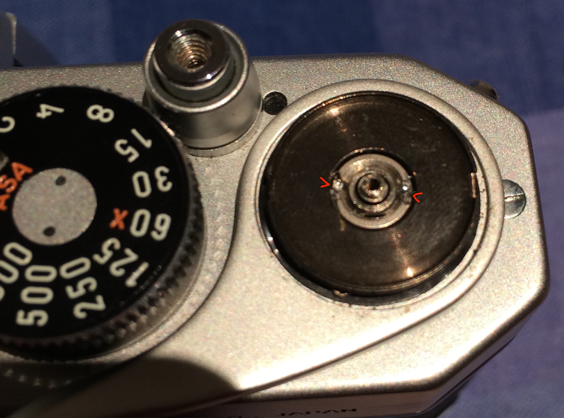

Nice! I tried to take off the top plate on a Spotmatic to replace its broken focussing screen, but couldn't unscrew one of the pieces, and what's worse, I pushed the rewind shaft in (after unscrewing its nob), so can't open the film compartment any more...
There’s a right-hand threaded nut over the counter dial shaft and it helps to make a special tool for it because it’s usually pretty tight.
And you can bend the tip of a paper clip to reach in and pull up the rewind
Thanks for the tip! I did manage to reopen the film compartment.
The piece I got stuck on is the nut (?) just inside the black disc (sorry for blurred focus). I bent my lens spanner's tips over it. Is it the one that has a right-hand thread?

I made a tool for that from a wide flat blade short screwdriver. I used a cutoff wheel on my grinder to cut the slot and shape it to fit.
That’s right-hand threaded

While you are at it. The two-dot screw on the film speed dial is the first place to show tool marks of an amateur. It’s normal thread but slip marks always tell a tale.
Try to make a tool dedicated to that part that can remove it without slipping or scratching. I made one with a couple nails in a small piece of wood, and filed the nail tips until they just fit
Right. I hadn't unscrewed this - probably the holes are too narrow (and too narrowly placed) for my spanner, or I just hadn't come that far... The right-hand nut seems stuck, and I don't want to risk breaking the spanner tips altogether. Will have to leave it till I have better tools at hand.
On closer inspection, it seems to be the pentaprism rather than the focussing screen that's broken, so would need a Spotmatic donor (I was hoping I could fit in a split-prism screen from a Fujica ST605, which probably wouldn't fit anyway). Pity as it's in a pretty good shape (if only an SP1000) - probably broke early on and never saw much use.

Is it broken? Or just has an ugly black line? That’s the damage of rotted foam. A donor would be a good idea. 20 bucks plus shipping should get you a good donor body
