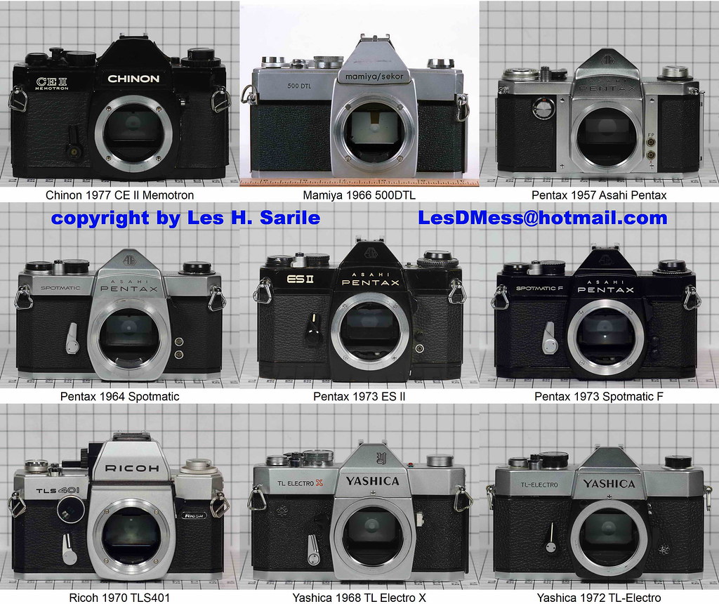

These are some of my M42 lens mount cameras . . .
Selection 75 by Les DMess, on Flickr

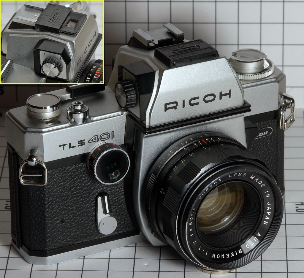

I'm interested in Ricoh TLS 401: it seems to be on the heavy side (like Chinon CS?), but I can think of occasions when its viewfinder might be useful. Can you recommend it?

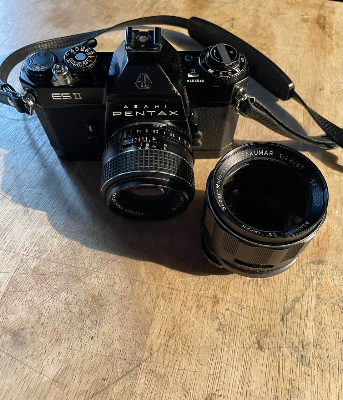

I’m bragging, but this is the best M42 kit on earth right now.
What makes the camera great is its recent complete overhaul and calibration. It’s the only 100% restored body I have right now. I bought a half dozen or so with the idea that I would fix them and get them out there. I spent a lot of time on a learning curve and I didn’t want it to just be so I could fix my own camera… but that’s where I am now.

I don't know what the CS weighs but the TLS401 is heavy at 787g compared to the Spotmatic F at 639g. I have tried the top viewer and you will have to put your eye closer and it does crop a bit all the way around the frame compared to the eyelevel view.
Ricoh TLS401B by Les DMess, on Flickr

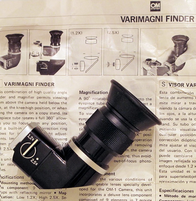

You might be better served with an adapter like the OM Varimagni Finder if it fits your camera. I've found it to fit quite a few of my cameras of various brands/models.
OM Varimagni Finder by Les DMess, on Flickr

How is your ES II working out for you? I occasionally consider buying one but have not acted yet. Is the viewfinder brighter than the original Spotmatic?
Bill Burk
Feb 9, 2010
9,432
This one’s perfect, but all the ES-II I bought have a cracked shutter switch. They always need foam replacement especially around the prism. Viewfinder is identical to Spotmatics. One had really bad CdS cells. They typically are ok mechanically except the mirror charge lever tends to stick. Might be weak second curtain spring but I usually tend to the latch for temporary success. Actually once in a while the mirror fails to return. So even this one could be better.
Nice! I tried to take off the top plate on a Spotmatic to replace its broken focussing screen, but couldn't unscrew one of the pieces, and what's worse, I pushed the rewind shaft in (after unscrewing its nob), so can't open the film compartment any more...

Thanks for the tip - an angle viewfinder probably does make better sense than getting another camera just for the purpose. Is the Olympus one better than others, or just any would do (there seem to be similar finders from Pentax, Mamiya and Yashica around)?
