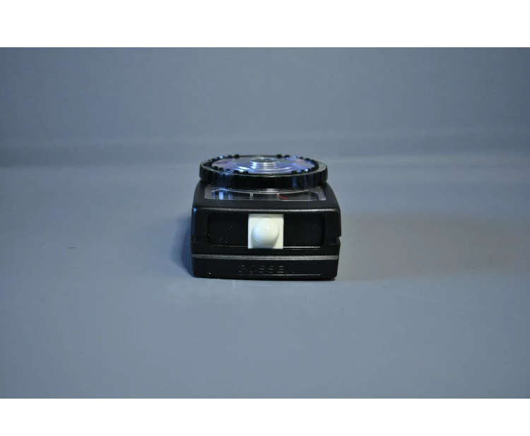

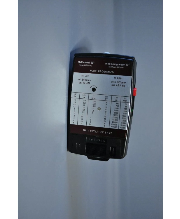

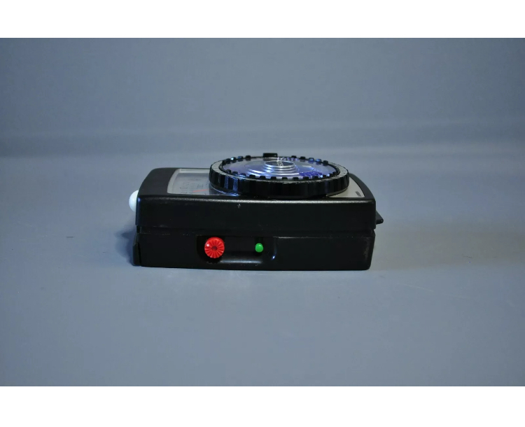

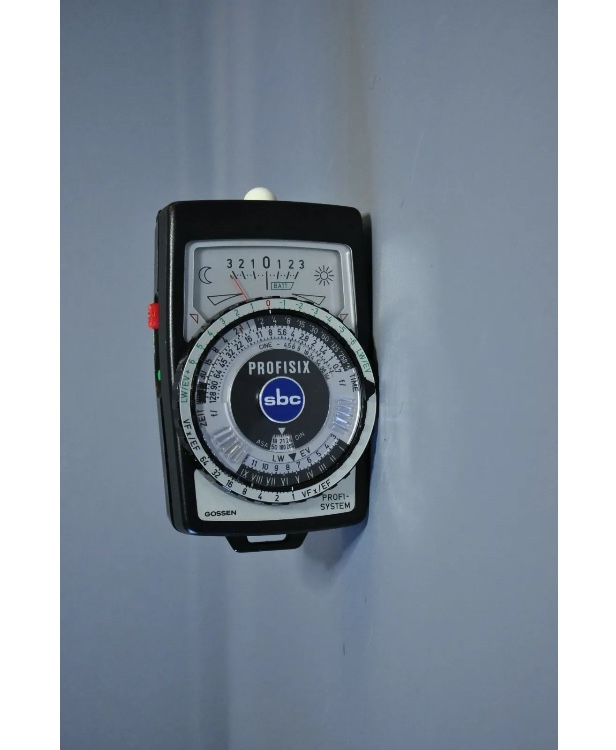

Great meter, bulky and boxy quite surprisingly, but not really heavy. In case you have not seen this part yet, it is expandable into several other areas with attachments, including multibeam spot one, which is not too easy to find, but it does do a lot of additional goods to it.

it is indeed a great meter. Just went back into my materials and Gossen at one point decided to dump the cinematographic scale and replaced it with Zone System scale. While most Luna Pro SBC I have seen for sale do not differentiate often between the two, so prices are pretty much identical (and all over the place, from $50 to $200), but if sole purpose is to use it for photography, might as well look for one with Zone scale.
Null measurements are also great, had not used one before and came to loving it.
