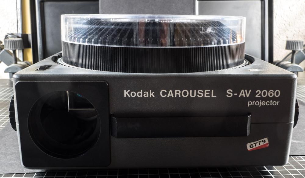

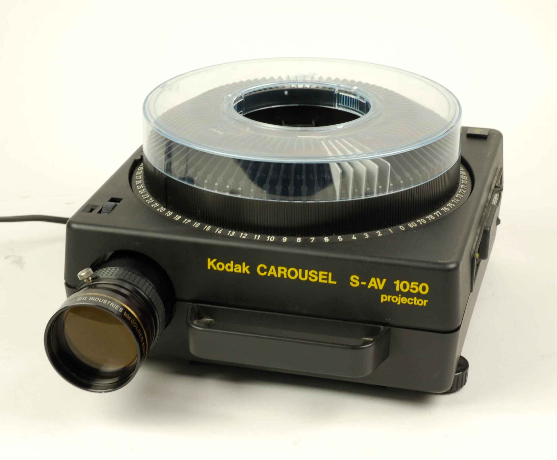

@Alan Gales Following on from my previous post regarding European models, here's the Kodak 1050, top-of-the-range model from the semi-pro line:
The exterior is built from plastic rather than the alloy used in the 20xx range. There are also some differences to the transport mechanism, all of which is reflected in their difference in weight: 20xx models weigh nearly 17lbs while the 10xx models weighed about 3lbs less. They also had a captive mains cable whereas the 20xx used an IEC 3-pin socket, aka kettle lead. 10xx models had 'amateur grade' features built in such as an interval timer and autofocus, and the cheaper variants didn't have AV sockets allowing them to be used in cross-fading pairs
