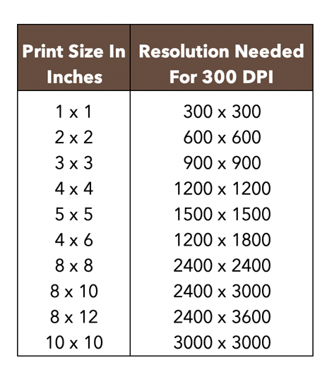

This chart might help.
I would suggest that you might scan for resolution 2400x3600 px and that will give you the option to make a 8x12 inch print or any size smaller because it is easier to go down but harder to go up.
In commercial printing, like a Fuji Frontier, the dpi is 300 as standard. As has been said in previous posts, you will not be able to visually tell the difference between a higher resolution.
