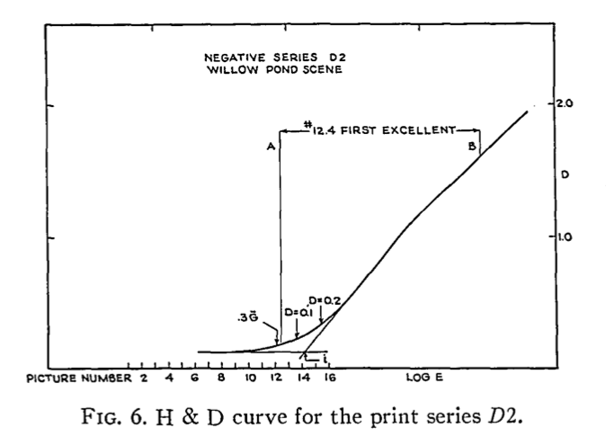

I am interested in the axis that defines print quality. Can you please explain?
A series of negatives, in which the exposure was increased progressively from a very low to a very high value, was made on each of these materials. From each of these negatives was made the best possible print which could be obtained by using any grade of a widely used developing-out paper. These series of prints were judged by 200 observers, each observer being requested to choose the first excellent print in each series. A Study of Various Sensitometric Criteria of Negative Film Speeds, Loyd A. Jones and C. N. Nelson 1940

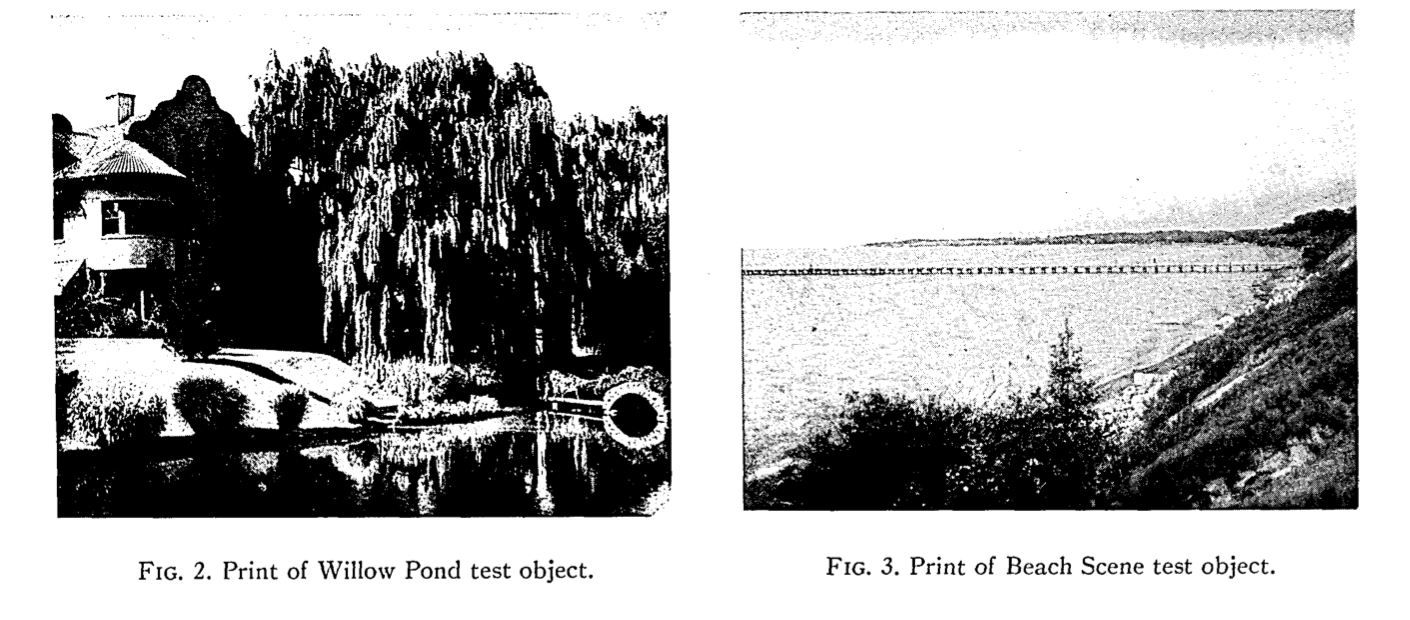

Thanks, but what is the subject of the image? As this would affect personal evaluation.

One was "Willow Pond", which Bill Burke tried to locate once. Others were "Beach Scene" and "Woods Scene."

Do you know of the original paper?? They made 8x10 transparencies of Willow Pond and the others. The transparency was photographed hundreds of times to make the negatives for the analysis. That is how they accurately got the values from the scene and ensured consistency. It is, of course, the fundamental study on which DIN, ASA and ISO are all based.
