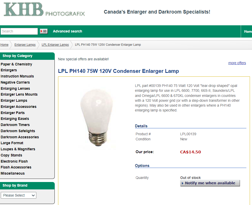

On the subject of using an LED bulb instead in a condensor enlarger designed for a teardrop shaped bulb:
1) with condensor enlargers in particular, the placement of the "filament" is important. Any LED bulb should probably mimic that; and
2) the colour temperature and "CRI" of the LED bulb may or may not give you the information that you need about the suitability of that bulb for variable contrast printing, because LEDs have spectra that includes spikes and valleys, and if those spikes and valleys coincide with the colour of light that the various emulsion components are either most sensitive to or least sensitive to, the contrast response of the filters and paper may be much less predictable.
Thanks - here is the incandescent bulb:
My Beseler 67CSXL (bought 1983) takes the same bulb. When the original bulb died, I could find no 220V replacement; bought a 120V from KHB, and rigged up a transformer. Then, out of curiosity, I tried a regular-sized 220V 75W halogen bulb. Test, works equally well. Keep in mind that a "condenser" enlarger is not a point source enlarger, so it makes sense that it's not that sensitive to the size of the light source.
Epilogue: having paid dearly for the imported bulb (shipping, customs, brokerage) I keep it in use, with the transformer.
As concerns the OP's problem. You might try a low-medium power LED bulb (say, 25W tungsten equivalent), 4000K, size A19 or A15 or S11. Not guaranteed to work, but cheap experiment. Check what goes on with variable contrast grades.
This may very well vary from enlarger to enlarger - but point taken.
I would expect that it is the positioning of the light that matters most.
