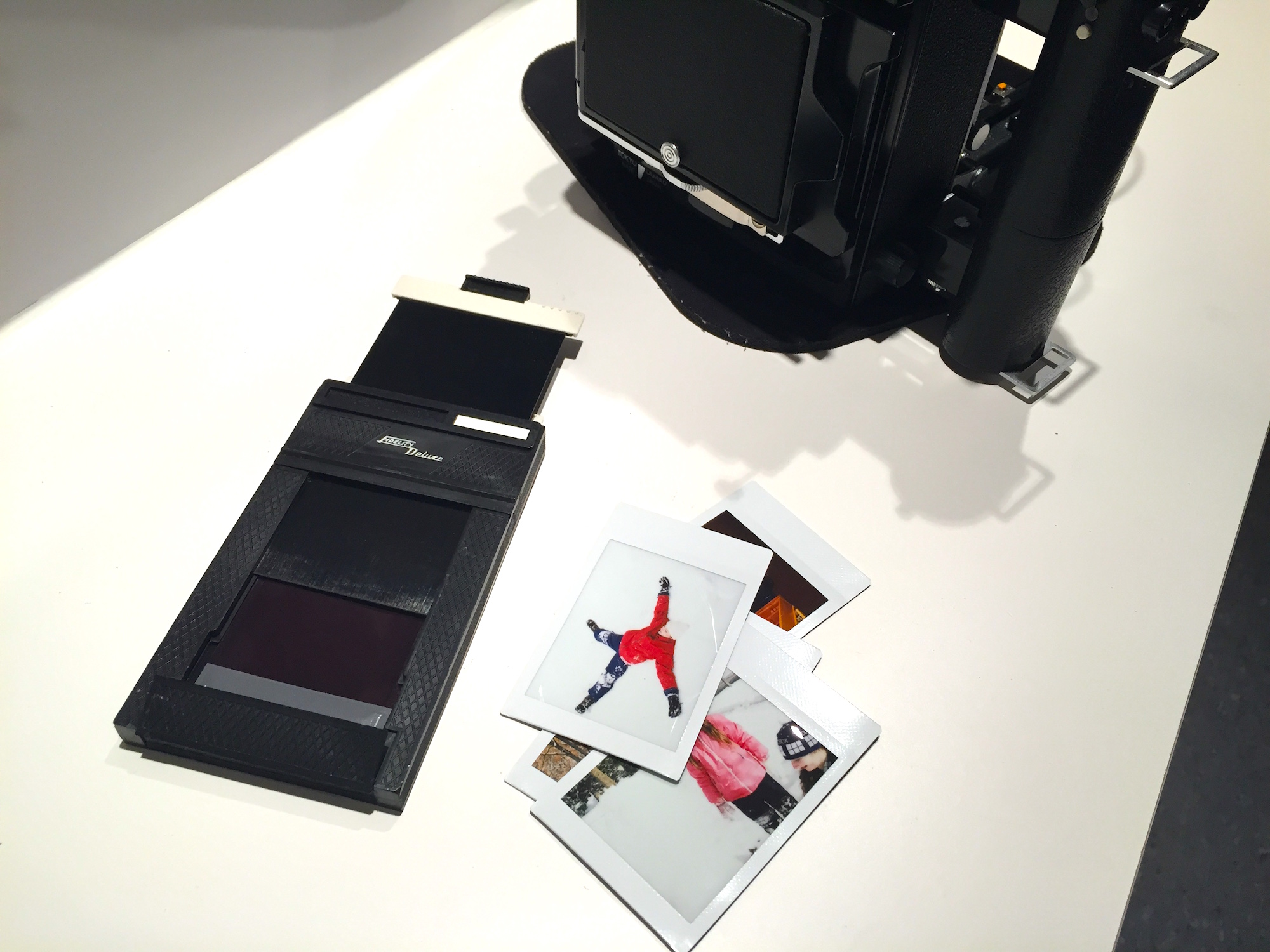

I use Instax film in a Horseman technical camera and in my 35mm camera's Polaroid back. The I use either the B&W or the Color. Both work very well and give good prints that are very easy and quick to process.
Can you quickly run down your process to handling the film?
The first 'exposure' of an Instax film pack spits out the light trap. Then, in the dark, remove the cartridge from the plastic instax camera and with your finger push all the film out the slot one at a time. To avoid focus errors and rangefinder calibration, I put the free pieces of film in a 6x9cm sheet film holder and expose them in a technical camera that takes sheet film. The Horseman is a hand-held rangefinder camera. After exposure, the film is removed from the sheet film holders in the dark fed into a spent Instax cartridge. There is a little plastic flap I remove to make this easier. You can load 1 or ten sheets into the cartridge. Then put the cartridge back in the plastic Instax camera and fire off the exposures with a lens cap on. Development is nothing more than a smooth run through two rollers in the camera.
You could do this with a film tent in the field.
I also expose it in a Polaroid back on a 35mm camera. That back has a dark slide which is nice, so I can pre-load the film before I put the film back on the camera. Only one picture per load, however. But I believe the Impossible film only gives one exposure also.
It is a little bit of a novelty, but a lot of film photography is novelty.
