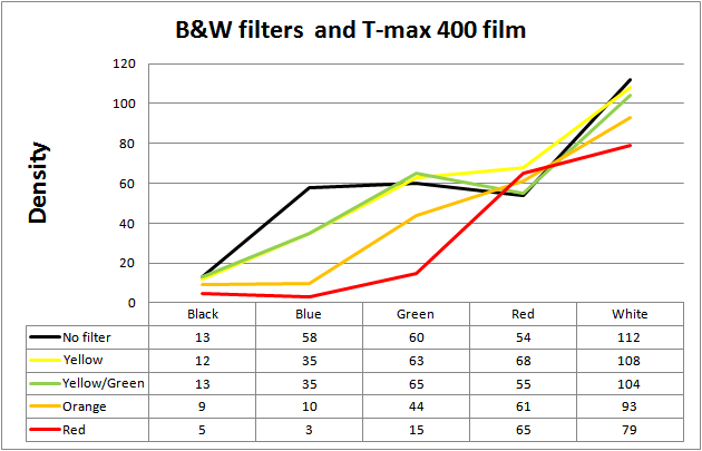

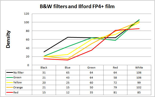

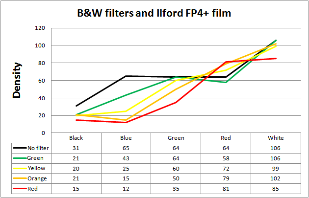

The following graphs show the effect of some filters on two different films.

How were those graphs created? How would I go about making some on my own? Probably it’s one of those things that if I have to ask… still would love to learn more.
Should be something that can be done with Excel or other spreadsheet programs.
