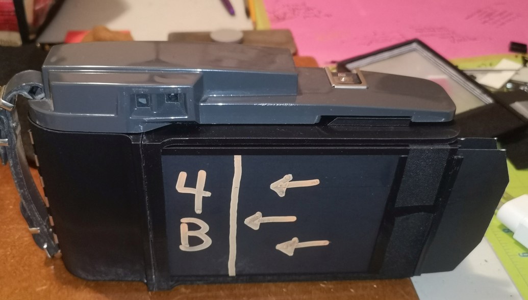

If you don't need movements and and want a fairly lightweight camera with a rangefinder, maybe the Polaroid 110A/B would get you started. It would need to be converted to 4x5, but there are various ways to do that. If you have access to a 3D printer, that would make it much easier. You can often pick up a good 110A for around $100 (with 127mm lens), and if you have access to a 3d printer, printing the back and even film holders probably doesn't cost more than $15. That'll leave lots of $$ for tanks 'n stuff. You can use this camera with a ground glass if you like, but I use it almost all the time with just the rangefinder. It all fits inside an original Polaroid roll film camera case or a small backpack.
Here's a pic of the back:
The film holders are custom sized to fit within the lines of the camera. You can convert these cameras to fit standard sized film holders but that would work better with a model 110B since the rangefinder/viewfinder are combined and farther to the left, making room for the 4x5 back.
