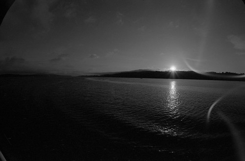

If you look at the first shot posted by Leighgion, you will note a couple of things:
1) the foreground is fairly dark - if I had to guess, I would say that the exposure was chosen to emphasize the patterns in the sky; and
2) it was shot with a very wide lens - so wide, that the corners curve, and the brightness dims out toward the edge of the frame, which also tends to emphasize the patterns in the sky.
I point this out to emphasize that exposure is often the factor that most influences the appearance of the sky. Very often the sky is brighter than the rest of your subject, so it can be easy to overexpose it.

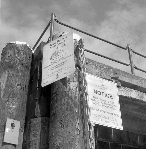

P.S. the following shows lots of detail in the sky, but really that only happened because I adjusted the brightness of this scan to show detail in the pier and the sky, and then burned the signs in heavily:
The lens used in both shots is a Nikon 16mm f2.8 Fisheye, which is wide as wide can be on 135 format among my gear. I don't feel though, that in this case that light falloff was a major factor. The sun was riding the horizon and sinking away, thus providing a lot more tonal range in the sky than exists in daylight, especially with the handy scattered clouds. In fact, I shot this from a different part of the boat just a few minutes after, which even with the sun in frame shows range in the sky:
I agree that it can't be overemphasized how much more important exposure is to getting tonal range in the sky than film, but development methodology is also very important. The shots from the ferry were done in D76 1+1, which yields negatives of considerably lower contrast than straight D76. Not my cup of tea for normal use, but very handy for reigning in certain scenes.
