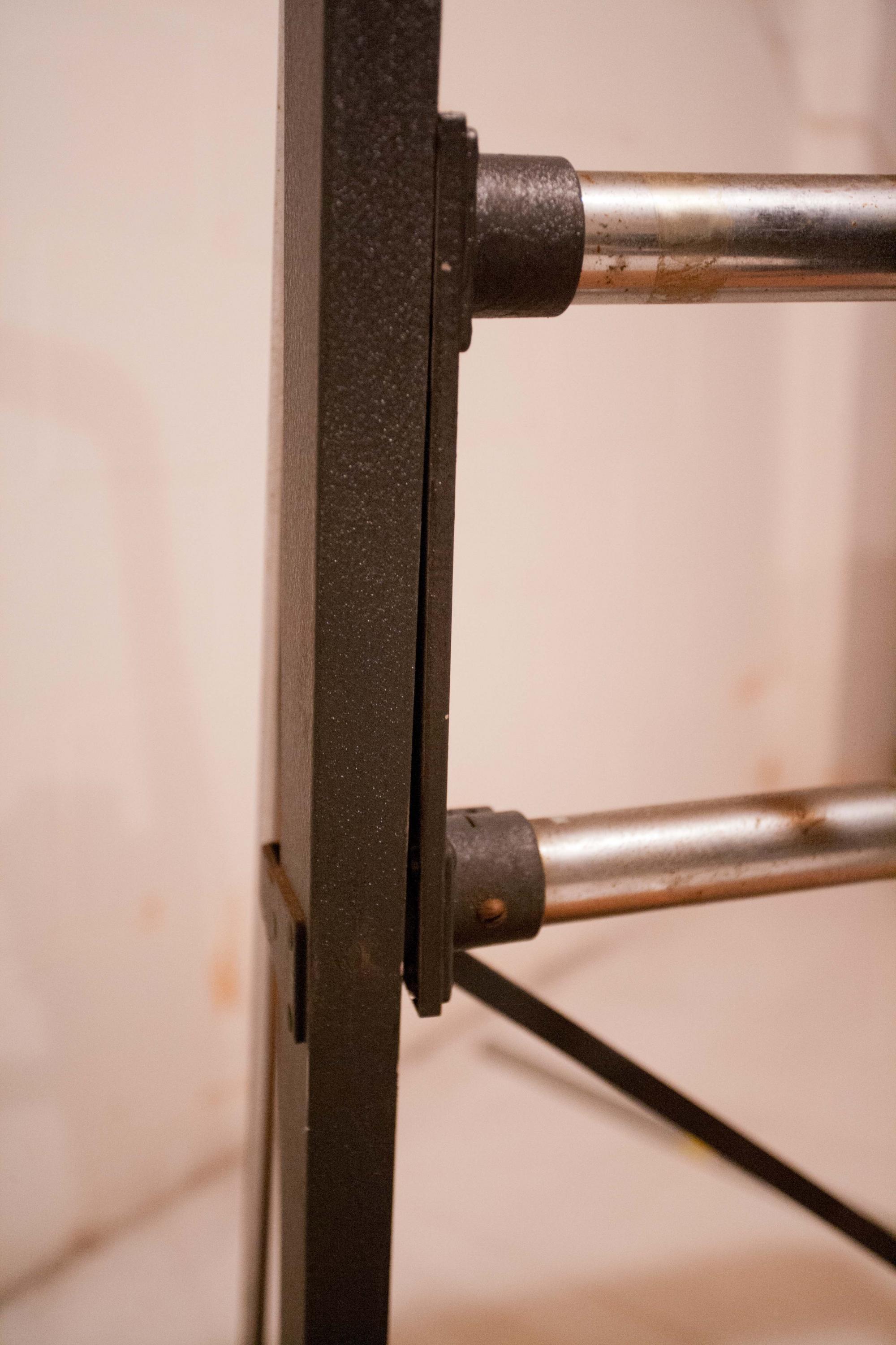

Another question: The roller guides tend to slide out of the uprights when I raise the enlarger. Is there any way to fix this?

Hi JPreston,
I just took a look at mine. While there is some flexion in the chassis, I'm not seeing enough to experience the same thing that you are. What I would look at in the following order are:
1) width of the chassis frame at bottom and top, expecting it to be consistent. If it isn't, I'd expect the only place it could be wrong would be the bottom, but that doesn't make sense if it's coming out of track when you raise it. I'd eliminate it as a possibility anyway.
2) Check to see if each of the tube receivers are tight. If they're loose, the receiver assembly could be sliding inward as you raise it.
3) If they're tight, they could still need to be loosened, spread out a bit, and re-tightened.
2 and or 3 are what my money is on. If someone disassembled it at some point, and didn't put it all back together properly, that's a reasonable explanation.
Eager to hear if you can solve it.
Kenny

So, I think the enlarger frame must have been taken apart at one point and put back together incorrectly. The drive gears were misaligned in the rail. I loosened the right side rail and made sure the drive gears were engaged with the correct teeth on each rail and all looks good now. The tube receivers were a little loose as well so I pulled them apart and tightened the screws.
