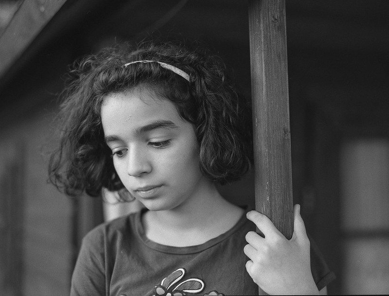

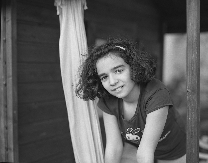

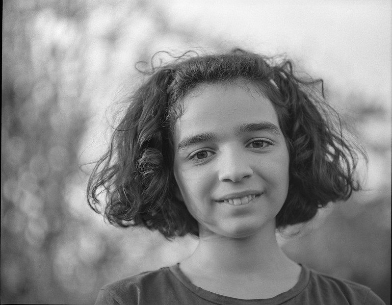

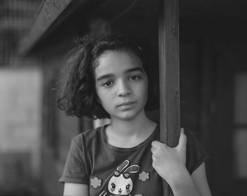

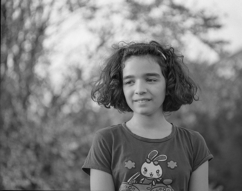

Hi!
I've tested the Bergger Pancro 400 with the Pentax 6x7.
As I want to use this film mainly for portraits I did the test shooting portraits. Violeta helped me again ;-)
I love this film. It really seems easy for the enlarger. I hope to check it very soon.
The negative is really beautiful. No grain at all or really negligible. Flat and nearly free of dust once dried.
It reminds me of the Trix400 I've developed with Perceptol or Xtol.
Pentax 6x7 MLU
(a) SMC Pentax 67 105/2.4
(b) Super-Multi-Coated MACRO-TAKUMAR 135/4
Bergger Pancro 400 :: XTOL 1+1 -> 18' a 20ºC
Presoaking 1 minute
"Agitated during the 30 first seconds, and then, ten seconds at the top of every minute" ---> http://bergger.com/media/wysiwyg/Fiches_techniques/Pancro400_en.pdf
TMAX Fixer 4'
Epson V500/ Epson Scan
LR 7
1- (a) cut
2 - (a) underexposed 1 step.
3 - (a) overexposed 1 steo.
4 - (a) underexposed 1 step.
5 - (b) cut
6 - (b)
7 - (b) Misse the focus ...
8 - (b)
9 - (b) Recorte
Two Trix400 shots just to compare:
10 -
11 -
Developed with con Perceptol stock.
What do you think?
Cheers!!!!
Antonio

Nice!
I have some rolls in 135 which i have been shooting with 3 stop bracketing. Going to develop in RO9 and D76 to find which one i like the most. Tour XTol results are lovely, need to try that as well!

I think your test frames are excellent, they agree with what I have found with the 4x5" Bergger film I have used. I find that Bergger 400 is very much like the late Fuji Neopan 400, excellent tonal rendition of subjects with a nice contrast kick that seems to be slightly different to any other film I have used.
I think you will be very pleased with prints and they should print easily, at least of what you have here. The Tri-X you have shown is also shot under similar conditions, as far as grain and other things, I think both films are quite close. Bergger in my opinion does seem to have an edge in that when one prints it, there is a terrific contrasty look, but with detail held in both shadow and highlight especially with images shot under nice portrait lighting as you have done here.
When my stock of Neopan 400 runs out, I will be switching to Bergger 400 for my 135 work.
Mick.

I think you take truly sensitive and charming portraits whatever the film!
^ probably not very helpful.
The Berger shots (to my eye) seem to have a wider gamut of tone (dynamic range? I don't know what is the preferred term for analogue photography) - very nice.

Great results, Antonio !
Your model is beautiful (as usual) - I like the wide range of midtones here.
I have 5 exposed rolls of Pancro 400 (2 of them exposed @Iso 1200) - I will try them with Xtol and Rodinal.
Thank you for sharing !

In my opinion (of someone who is more visually pleasing with a more pronounced contrast) and bearing in mind that there are many factors in the middle, I find a slight lack of overall contrast that helps those midtones. I wouldn't say TriX anyway.
Sorry for the silly question: What's the colour of the rabbit in that T-shirt? White?
Looking at that Xtol info. (mix/time) I guess you used it at box speed. Did you use the recommended sulphite bath after fixing?
Congratulations, and thanks for posting!
Warm regards!

Wow these are beautiful, i really like the midtones. Its soft and gradual where as Tri-x i find is not so subtle. I need to go into my wallet i guess :smile:

I agree with you about the lack of "overall contrast" ... But it reminds me of the Trix, a subtly less contrasty Trix. Hahaha, I need to shot more Trix, I guess ;-)
The rabbit ... ummm, I don't remember right know :-( Pinky?
Yes: Box speed ... no, dammit! ... no sulphite bath after fixing
