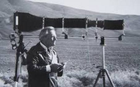

There's no issue with a 600 prime lens per se on a monorail. Just add more rail.
Not a problem with a 600, not a problem with a 6000... we may have to add some tripods anyway.
Reinhart at work:

Ha, excellent--I've never seen a print of R. Wolf's work, but one of the Fuller Building from his NYC project must be pretty cool. At any rate, thanks everyone for the feedback--you're not helping my bank balance, however.

That is from "Castles in Spain". Old Style 1000mm Zeiss lens I think. I have the 800mm and 890mm Apo Ronars and I want to try this type of rig. :smile: Glenn Evans forward mounted my 800mm F9 (on a custom milled Norma board and tube) to work with my Norma shutters a few years ago. It's also a beast of a lens, beautiful to use.
The only thing I would add are the rare Norma Clamps (which I have just acquired) and the red Stabilizing Rods (I have a bunch of those). I will also use two FOBA C40 which were designed to seamlessly work with the 8x10 Norma. They are in the Norma catalog and weigh a ton but do the job wonderfully. And they set up in seconds with push button super speed.
All of Wolf's work (and many books) are over the top. I think I have all of his books? "New York" is my favorite being the first I am aware of. Today I enjoyed revisiting "Villas of the Veneto" which is another photographic tour de force.

Very impressive--approaching "crew served" proportions, though: I think I'd roll with a key grip and focus puller.:smile: (FWIW, Christopher Burkett's color work induces delusions of grandeur in me as well--it really does seem to be a great strategy for tackling a cramped, deciduous forest though.)
Quoting Arne Croell: "Reinhart Wolf used the Apo-Ronars 360mm, 480mm, 600mm, and 1000mm for his 8x10 photos of New York skyscrapers (in the book "New York") and of Spanish castles ("Castillos"). That is quality assurance enough for me. "
That one pictured should be the 1000, I guess...

The earlier rig photo in "New York" shows the 1000mm with a 5x7 Norma Back.
Quite possible a 5x7 Norma Rear Standard at the front end of the 1000mm. Quite clever and unique. :smile:
Does anyone know any more details on this?

Just do what's instinctive. I lean toward long perspectives in all formats, but have done plenty of moderately wide shots too. But there are easier ways to do it than multiple tripods. I shoot a Norma too, but Reinhart obviously wasn't a backpacker. In fact, I don't encounter any backpackers wearing ties, regardless of camera size. The whole point is to be uncivilized. Apo Nikkors graphics lenses are wonderful distance optics; but it's just so much easier to tote around Fuji C's.
