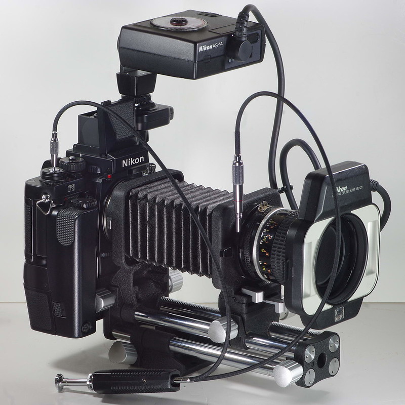

Nikon F3 DW-3 MD-4 PB-4 AS-17 AS-14 SB-21 AR-7
The rail movements are very smooth. The PB-4 even has a little tilt and shift. For straightforward simple magnification, any bellows in good shape should be fine.
F3 DW-3 MD-4 PB-4 AS-17 AS-14 SB-21 AR-7 by Les DMess, on Flickr
You can even reverse mount the lens for greater magnification
Macro Lens + Autobellows by Les DMess, on Flickr
