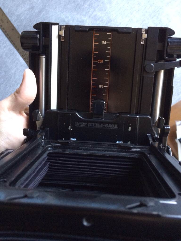

And... Look what I just discovered on my camera!
However it only seems to be accurate when the rear extension is not extended, and the front extension focusing knobs are not extended either, so I guess it's useful in certain certain circumstances but it's poorly placed, it's also not accurate to the actual distance, but rather to where you can view the distance, what I mean by that is obviously as you can see there is a piece of plaster sticking out from further than the actual lens board area, so that number seems to correspond with the actual lens for distance from the film plane, not the actual physical distance from the number markings to the film plane.
Either way it's handy to have in a pinch, so long as you realize that it doesn't account for the front and rear extensions.
It's also poorly placed, it could've added some kind of track system on the side that would've made a lot more sense, but at least it's a start!

Look on the side, or maybe even on both sides. Isn't there a blank scale that you can mark?
Yes, I was going to mark infinity spots for my lenses for night work (so I don't have to show up 3 hours before when there's still light to focus :wink:

Also in a secondary "duh" moment, I was looking at my own picture of the 4 x 5, and I noticed that the scale read 100, 200 150, but the 200 was in orange, I've now realized that the 200 is the marking for when the rear part of the camera is extended. I guess the engineers at Toyo figured some things out even if I'm too blind to notice them :wink:
