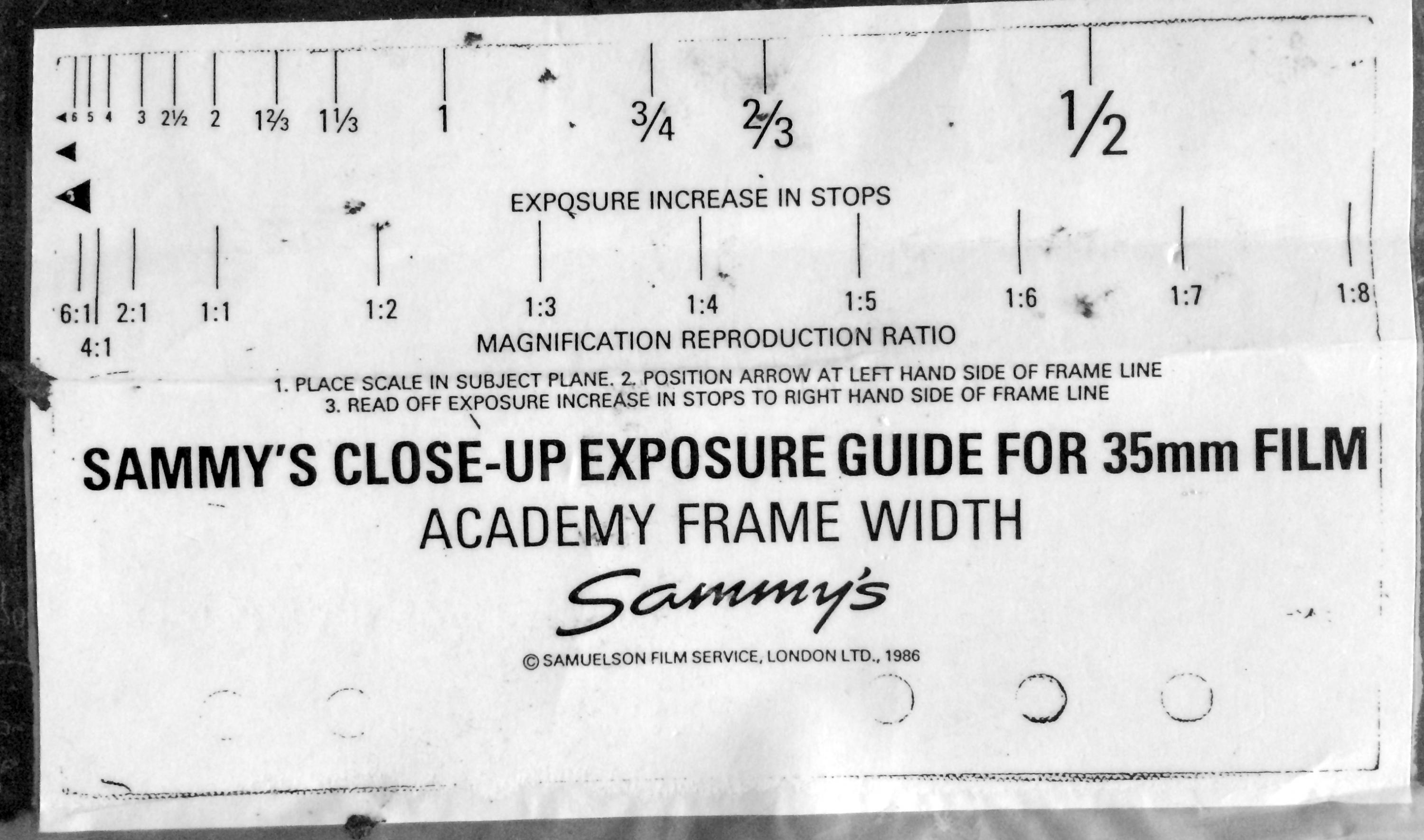

Another device to me sure bellows compensation
Please see the attached for another tool to workout bellows extension
this one was for 35mm but the idea will work with any format
robin
