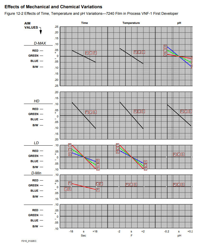

Okay, something amusing. Kodak have published a series of very interesting documents, but unfortunately they still haven't done so for the E-6 process. However, if we look at the VNF-1 process, which should be somewhat close to E-6, we can see what happens when time and temperature are changed. And here's the funny part… in theory, such a compensation by AGO would slightly affect only the red channel at DMIN…
