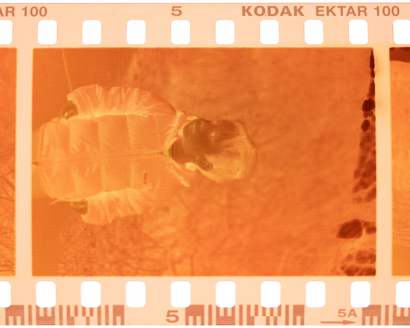

@Mikey Antonakakis , thanks for posting the examples; I think the help. As you cal tell right away, the first and the last strips (rocket launch & kid in jacket) are underdeveloped. The second strip (mother pushing pram) looks normal. Note in particular the density of the edge marks and also their hue. This all looks like insufficient developer activity due to a temperature control issue, a mixing error or exhausted developer. Re-bleaching won't do much.
The reason why I requested photos of the negatives is also clear from these examples; as you can see, the scanner 'fixes' the lower density of the faulty negatives, making it appear if they're just a little grainy. But the real problem is that they're very low in density, especially in the magenta and cyan channels. The graininess is just an artefact that emerges as the scanning software boosts contrast.
Thank you for the assessment, it sure seems like development issue to me now. I remember thinking as I pulled the roll out of the final rinse "hmm, density doesn't look terrible, but sure looks monotone..." So digitization noise makes sense. Maybe I will scan samples from both rolls again to check the histograms and see if I can get any process-control insight for my future reference.
My previously-stated notes for the Ektar development were mixed up with the second roll I used with Bellini kit, so here's what actually was done for the Ektar roll shown in the photos:
  • First roll developed with freshly-opened and mixed Bellini kit, in a small Jobo tank
  • Chemicals mixed per Bellini instructions (I used the 1L kit)
  • Prewashed at ~38C for maybe 5 minutes, I intended 3min but something delayed me
  • Developed at 38C for 3:15, agitating per Bellini instructions
  • Bleached for 0:45 with continuous agitation (bleach at or slightly cooler than 38C)
  • Rinsed with water briefly before Fix
  • Fixed for 1:30 with continuous agitation (fixer at or slightly cooler than 38C)
  • Rinsed for 3:00 with ~38C tap water
  • Stabilizer as last rinse step before hanging to dry
  • After drying, did a bath in Kodak FLO due to some streaks
As far as I know, the main issue I had with my development was too-long prewash. There's also a good chance I mistakenly targeted 102F instead of 38C (as mental carry-over from starting with Cinestill CS41 kit), but if so I imagine it wouldn't be the cause for my underdevelopment.
Regarding too-long prewash, I have done two rolls so far in the Bellini chemicals - the Ektar shown above (first roll), and a 120-format Portra 160 (second roll). I am not 100% sure it was the Ektar roll, but I remember that when I dumped the prewash water it was a dark shade of green, I was quite surprised. I also don't usually prewash, so wasn't sure what to expect.
The 120 Portra roll seems to have come out better, although I used a different scanner and lower 2400dpi (vs 4000) resolution for the 120 Portra roll the grain/noise looks much finer/nonexistent. I will take a similar light table shot of one of those negatives a little later.
This could work, but I'd suggest the following:
* Scan using the slide/positive option and not as color negative. This bypasses all manner of color corrections and probably gives you the closest to a 'raw' scan.
* Keep a reference negative (known-good) on file and using a flatbed scanner, scan it along with a sample negative you want to assess. This way, you get both negatives in one scan and you can more accurately judge how they're different.
I wouldn't worry about that; it won't cause this kind of dramatic density loss.
102F is 38.9C and would have caused minor overdevelopment; in all likelihood, you wouldn't have noticed it.
So it seems there's yet another factor at work that you haven't identified yet. If you reuse your developer, I'd suggest fresh developer for your next run.

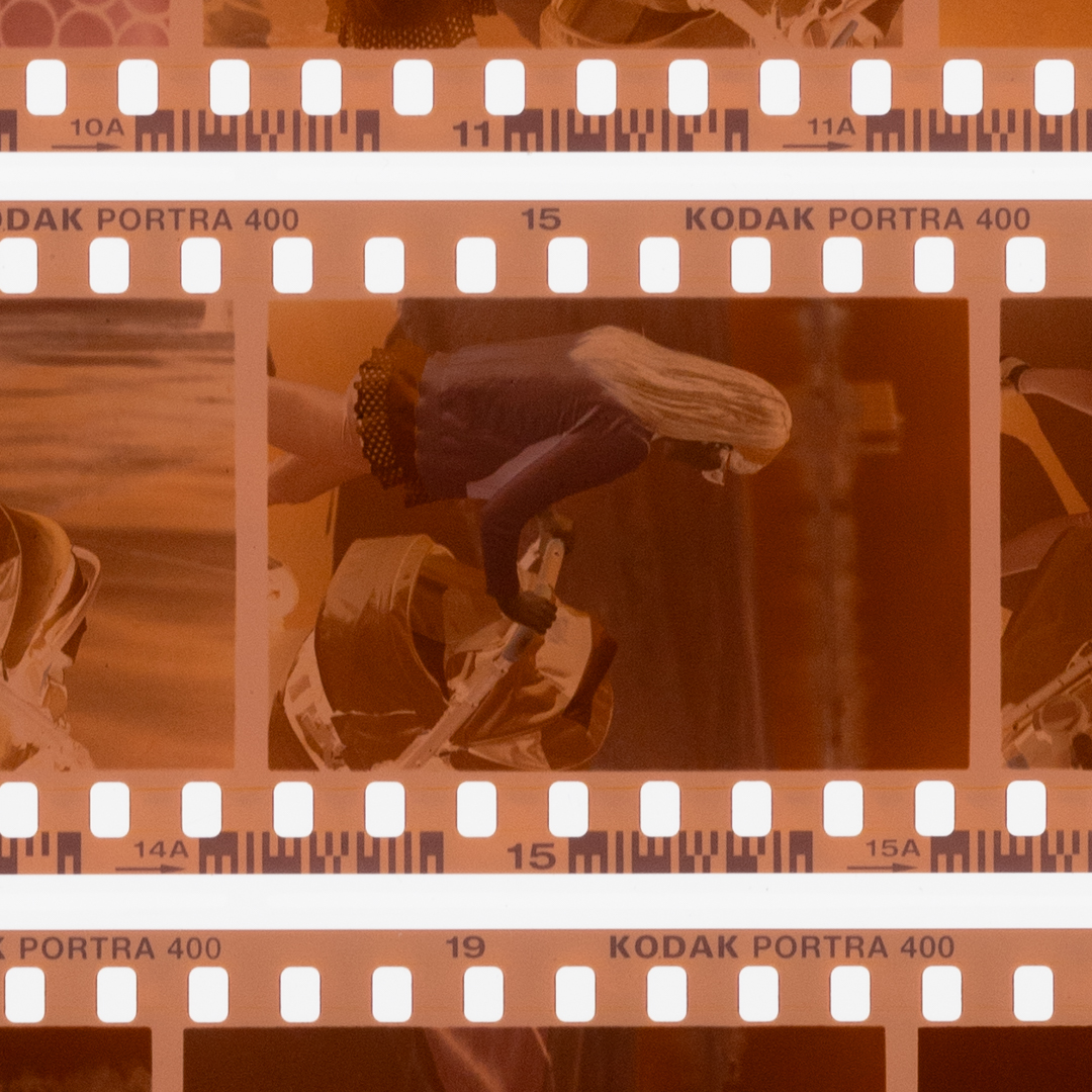

  • I think the roll of Portra 400 with the "mom pushing baby" shot shown above is my best reference for now; I will use it. That said, as I examine other Portra 400 I have, this reference roll seems to have a more magenta base... I'll post an example
  • For the Ektar roll in question, it was the first roll on the freshly-received and freshly-mixed kit, so I suppose if it's an issue with developer itself, I should just toss it. I was hoping to avoid the Fuji Hunt kit for now (it will require me to shoot more film! that's both good and expensive), but that's my next step. In the meantime I will shoot a test roll to try the Bellini kit once more.
Comparison negatives next, shot on mirrorless on light table, framing, exposure, etc. all identical. In Lightroom all white balanced to same spot on the PrintFile label and all +1.0 exposure. Large variation in actual scene color/contrast. Tried to include some exposed leader if I had it.
Lab-processed, EOS A2E:
Same Lab, within a week of above, EOS A2E:
Home-developed with freshly-mixed Cinestill CS-41 kit, developer per kit instructions, EOS A2E:
Home-developed, freshly-mixed Bellini Kit, Ektar 100 EOS A2E:
Home-developed, roll #2 of the Bellini kit a few days after Ektar 100, Bronica S2A metered with spotmeter and rough zone system:

Any feedback on the 120 Portra, since it was also done with the Bellini kit? Mom was wearing a bright salmon/pink jacket, otherwise the scene was pretty dull winter colors.
Hard to tell - if it scans OK, I wouldn't worry about it too much. In the end, that's what matters: whether the photos come out to your liking!
