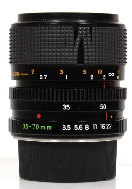

Depth of field is on your lens.
Where is it on my lens, and how do I use the scale on my lens?
If it is this lens, I don't thing there are any Depth of Field scales on it.
https://lens-db.com/yashica-ml-35-70mm-f35-48-1986/
There is a noticeable difference in the depth of field characteristics of your lens between using it at 35mm and at 70mm.
And once you have a little more experience with this, you will find that you can really notice the differences between depth of field at 35mm, 50mm and 70mm - at least near the f/3.5 end of the aperture range.
This is exactly my lens.
Zoom lenses most often do not come with any DOF scale marks on them, when the zoom FL is controlled by a rotating ring design.
Zoom lenses that are push/pull for FL often had DOF scale marks, because the push/pull design permitted lines that spread out more at shorter FL, and narrowed at longer FL..

I thought my lens would have this because of that red line that doesn’t move on the lens barrel. Next to it there are two more red lines that only stay on the part before the focus ring, and the third line has a ‘35’ on it.

As you can see from the scale on the lens wiltw posted, the depth of field centres on the plane of focus. So, you focus on the eyes, the nose and hair are also in focus if within that depth. Assume that exact sharp focus is always just a fixed distance and that some area in front of and behind that is mostly in focus, and that area is more or less dependent on aperture. That's not really correct but it's practically correct enough. In other words, go with that idea and everything will work fine.

It’s a prime lens, so everything I see in the viewfinder is always at f/3.5, which really sucks.
As mentioned earlier, "prime" lenses are lenses of a single focal length - not zooms.
And the fact that everything you see is viewed through the maximum aperture means that the camera and lens combination features what is known as "open aperture metering". That feature is an advantage, because it means that the viewing image is always at its brightest, and the focusing through the viewing system is easiest.
If you wish to be able to view at the lens aperture set by you, you need either an older camera where the viewfinder dimmed as you adjusted the aperture for metering, or a camera that has a depth of field preview feature.
There was a relatively short period of time long ago when open aperture metering was becoming common where cameras were equipped to use older lenses that didn't have the necessary open aperture levers built in. And there are still some really old lenses around that won't work with open aperture metering cameras in that mode, but I don't know if any of those old lenses would fit your Yashica camera body.
Over many decades, I've had many cameras with a depth of field preview function built in, plus quite a few that don't. When I've had it, I've rarely used it.
Take some photos with different settings and at different working distances. Make some notes. Then look at the results. You will get a good feeling for how it works soon enough.
