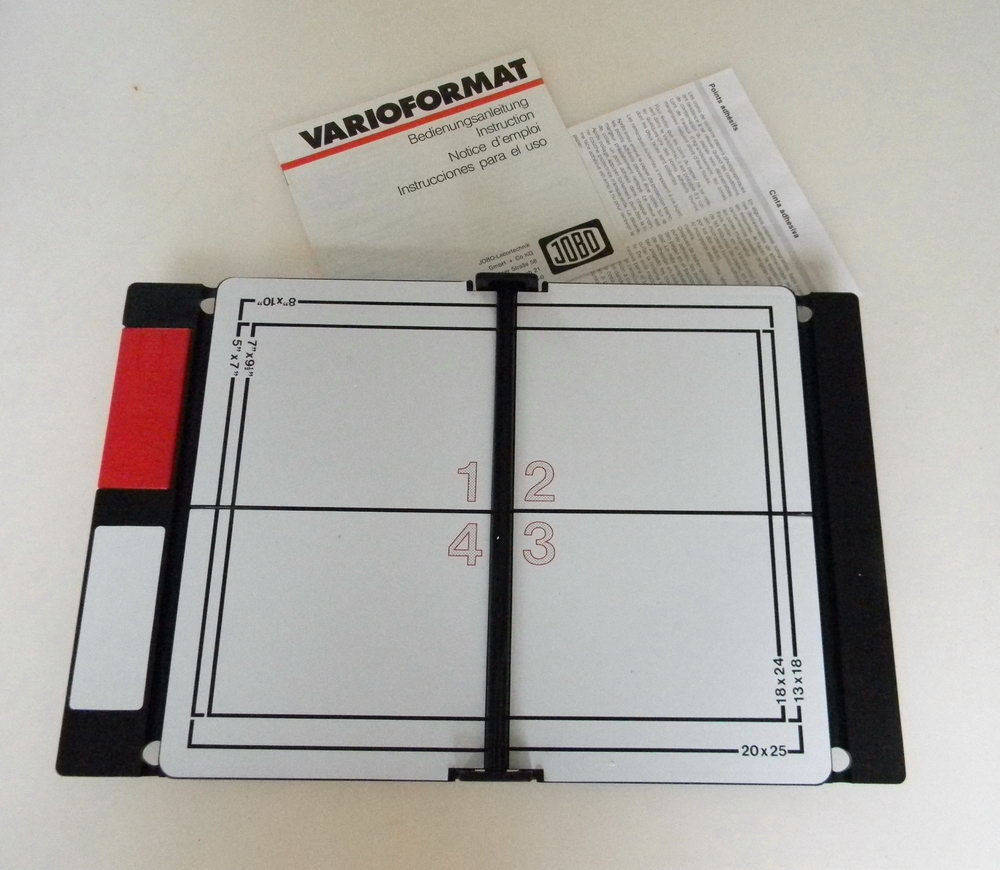

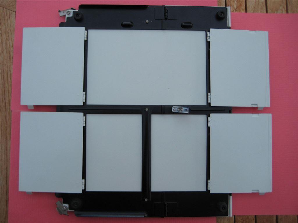

John, are you sure you are not referring to the likes of Jobo varioformat / Durst comask?
I think, the above easel allows you to print 3 different sizes on one paper and no more (although I have not used that easel or any other). On Jobo/Durst, you can do four 4x5 or two 5x7 or two 4x5 and one 5x7 size prints on one sheet. They both had paper strip versions/ attachments as well.
I think you're right. First glance I assumed that the frames could be moved to give the 2, 4 , 8 variations but with a proper look, I can't see how that could work. Maybe it's for fancy portrait display?
Mine is a Premier Model 61, the only one I've ever seen. Will give 2, 4, 8, up to 20 test strips, and 10x7 as well as 10x8.
ivanlow, apologies for the misinformation.

John, it would be nice to see a photo of your easel if you have time. I could not find anything online. Thanks

The 2nd one is a Durst Comask. I lusted over one of those in the 70s. Way expensive back then, 2 or 3 days wages for a labourer iirc. Made of metal. One side gives you 10x8 with a fixed border, like the Paterson easels. Other side gives you either four 5x4 or two 8x5.
Been a while since I've seen an easel on ebay that gives 8 prints to a sheet. The extra masks can be made if you can cut (black) card in a straight line. You'll only need 2.
Seems the type you posted are not for getting multiple sizes from a 10x8, they are 3 easels in one. You need to have the correct sized paper for each.

I have something similar made by Unicolor back in the day. I forget the name of it but can look later. It holds an 8x10 sheet (and can be used as such to make a 7x10 or so full frame print from 35mm with just top and bottom borders on 8x10. It has multiple different sized blocks you can put into the easel over the paper, a white side and a black side on each block. You put the blocks in white side up, compose on the one you want to print on, turn off the enlarger, remove the block and expose, then replace the block black side up. It allows two 5x7s, or a 5x7 and two 3.5x5s, or four 3.5x5s or eight wallets (half of 3.5x5 so I guess 2.5x3.5 or so) and so on. It actually works great and is very easy to use. There will be small black lines between the prints assuming light spills over there, but that's fine and makes them easy to cut apart. I used it mainly for color way back. Now I never print smaller than 5x7 and can (and do) buy paper in 5x7 size.
