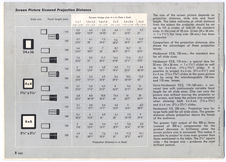

The Rollei P66 is a good choice. You may even be able to find a bargain in a P11 which will give you the ability to project 6x6, 35 (and superslide) all in one. I'll attach the Rollei guide to lenses/projection distance/screen size which you may find useful in your selection. rolleiP.jpg

attachment.php
Thanks for the info. I think I'll get a Rollei 66.
