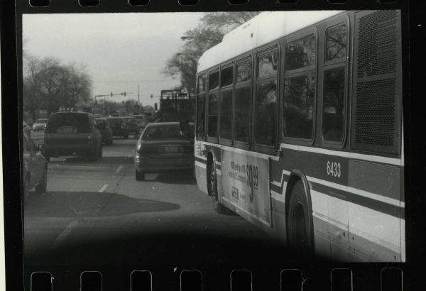

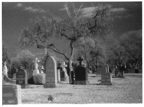

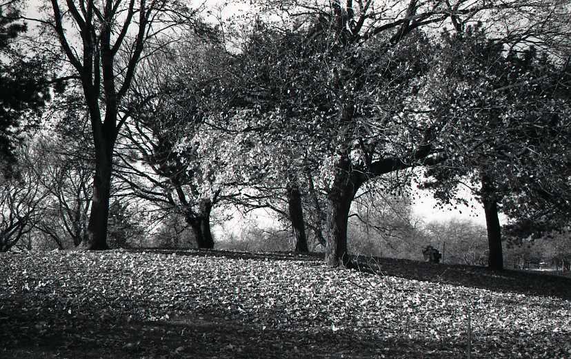

Im a beginner and i tried to print a 35mm. When i took it out of the fixer the print was beautiful and sharp with alot of detail. After it dried it was garbage ! it was so flat and dull with all the sharpness totaly gone. Does anyone know why this happened after it dried ? Thank you for your response.
First image is the original negative scan
Second image is the print that went bad after it dried
Third image is another print that went bad when it dried

How long did you fix the print? How long was your wash cycle? Resin coated or fibre? Matte or glossy. I'm guess you used matte resin coated, multigraded VC paper. If there was insufficient washing time, you can get dull, lifeless prints.

trees and hill
Paper Ilford satin multigrade rc
Developer kodak hc-110 Dul 2-15.5 for 1 minute
Stopbath kodak for 10 sec
Fixer kodafix for 2 minutes
Rinse for 5 minutes
Exposure F11 for 30 sec
Cemetery
Rinse for 5 minutes
Exposure f8 for 20 sec

Hi, HC-110 is a film developer, I don't think it is particularly good for paper. Try Dektol instead. Hal

R09 is also a film developer. I have not tried to develop paper in film developer – but like Hal I believe that this is the root of your problem.

As said earlier, you need a paper deveoper. RO9 isn't one either.
In my experience, the Ilford RC satin paper looks very flat when dry compared to when wet. This effect, coupled with your very short processing times, could be the problem. I would be using longer times in all three chems.
Another variable you are not mentioning is the filtration you are using for contrast, if any.
I would suggest getting some Kodak Dektol or Ilford paper developer, and some glossy paper. Read the directions and follow them for all of the chemicals and the chosen paper, and see if your results don't get better.

isn't that film developer as well? Also, when using paper developer the prints need to develop for 90 secs.
what was the filter grade?
Prints look better wet than dry, and you need to figure out the dry down times and apply. RC paper has less dry down than fiber, but it can look quite different when dry.
What is happening is just the learning curve , and we always end up with more prints going into the learning bin before they are ready for the wall.

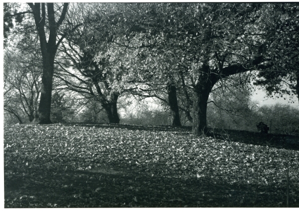

I bought a bunch of paper from a photography student on Craigslist, i bought apx $200 worth of paper for $50 ! i thought i got a good deal ? I already dont like the satin paper and that is 50% of the paper i bought. I have only been printing for the past 36 hours. in the past 36 hours i bought an enlarger and paper from craigslist so you can see that im a beginner but i think i will figure it out soon. I will get some Ilford paper developer tomorrow if the photo supply store is open. Thank you for your responce.

I think the paper is bad ! I just made another print with the pearl paper and when it dried it looked very good compared to the other ones that are on the satin paper. I know the scan of the new one with the pearl paper looks bad but that is just my cheap scanner i used. here is the pearl paper, its was done quick so i can try the pearl. It just a CTA bus in chicago, not to interesting.
Since you bought the paper secondhand, that is indeed a possibility; however, don't ditch it just yet. Different papers often require slightly different development times, so it's entirely possible that you underdeveloped the satin paper and properly developed the pearl paper.
I know that both HC-110 and Rodinal (R09) can be used as paper developers; however, as this thread indicates, most people prefer to use developers that were created with paper in mind. There's nothing wrong with experimenting with HC-110 or Rodinal/R09 on paper, but for learning I certainly concur with the others who say you should try a common paper developer. Note that development times vary both between papers and between developers, so development times for Developer A may be off if you use Developer B.

Thank you to everyboby for all your very helpful advice. I will get the proper developer and decide if i want to use the glossy or the pearl, i will dump the satin or i can use it for test strips. Again thank you very much !!!!

Don't discard the satin - it definitely has its place for the right subject. I would just suggest that you put it to the side for a while, while you learn on glossy or pearl.
I'd recommend looking for an older Kodak Black & White Darkroom Dataguide, or some similar publication. They have samples of different textured papers (using Kodak letter codes) and they'll give you a sense of the differences, and appropriate uses for more textured papers.
IMHO you may be making the learning process just a little bit more difficult than it need be. Using old paper, and non-standard developers, may result in erratic and unpredictable results. I would put them aside for a while.
What you need is consistent paper and consistent chemistry, so that any change in your results will flow from changes in your technique (which you control).
Once you gain experience with standard, new paper and the correct chemistry you may find it fun and useful to try the old paper, and see how it compares. It may be fine, in which case you did get a bargain. Unfortunately, until you have some experience, you probably won't be able to tell :smile:.

The satin paper will last for several years so just put it aside somewhere dry, and preferably cool, until you want to use it later. I prefer the satin to the pearl MGIV but that's just me...
When wet the pearl or satin will essentially be glossy from the water on it so when they dry you will see the loss in sparkle that you describe. It just needs adjusting when you print - generally by printing at a higher contrast. A hair-drier can be used to speed up drying small RC test prints - I tend to just squeegee them as that alone gets them 90% dry.
