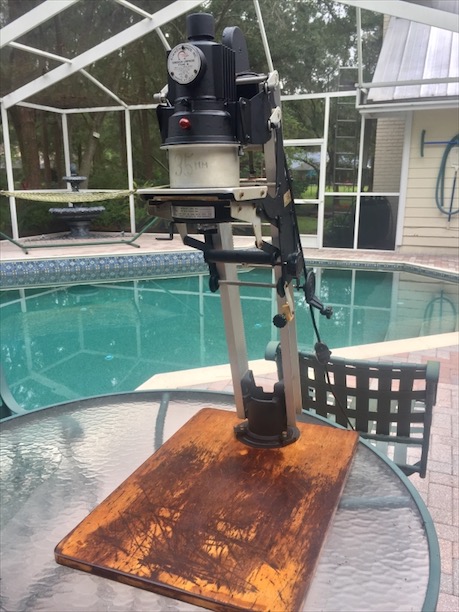

I just spent the last 3 hours cleaning up that enlarger. I took it all apart and am in the process of staining the baseboard. I scrubbed all the surfaces with a coarse brush and CLR while my girlfriend painted all the black surfaces after me with flat black paint (she wanted to, she rocks). I’ll have to put at least one more coat of stain on the baseboard but it’s all looking pretty sharp and much happier now. I’ll post a photo in a few days once everything is back together.
I think I have an idea how I’ll fix that crank as well.

I've ordered a Componon 80mm for MF that I suppose I could also use for 35mm. I'll pick up a Nikkor 50mm 2.8 eventually.
Remind me - do you have a condensor setup for 6x6? Because the pictured condensor seems to at least be labelled as "35mm". You will find an that an 80mm lens will be frustrating with 35mm negatives, because the prints will be small.
The B-8 has a basic condenser set for 6 X 9 negatives. There are supplementary condensers for 6 X 6 and 35 mm, but the former isn't needed when using an 80 mm lens. Sam already has the supp. condenser for 35 mm.
"The B-8 has a basic condenser set for 6 X 9 negatives. There are supplementary condensers for 6 X 6 and 35 mm, but the former isn't needed when using an 80 mm lens. Sam already has the supp. condenser for 35 mm."
I take it then that the 6x9 capable condenser set remains in place at all times, and will be present in the enlarger pictured above.
In other words, that tube with "35mm" written on it didn't replace the 6x9 condensers.
The big 6x9 condensers are set up in the can that is labeled "35mm" and remain there at all times. There is a place for a supplementary condenser to be placed just below the lamp. The reason the can with the big condensers is labeled "35mm" is because the enlarger came from a university and was set up for 35mm (had the 35mm supplementary condenser), so the professor just found that as the most convenient place to label that the enlarger was set up for 35mm (I assume).
Bob let me know that an additional supplementary condenser made for 80mm lenses isn't actually needed, so I have everything I need. I'll just take out the 35mm supplementary condenser when printing with the longer lens.

Also, good news! I fixed the gear on the enlarger so I can now raise and lower it with the lever. So now everything is working as it should. Once the sealant I applied to the baseboard dries I'll be able to put it all back together and have a brand new 60 year old enlarger (I hope I look that good in 40 years).
Reassembled! All the parts dried so I was able to get it back together and it looks a whole lot better. But, most importantly, it doesn’t shed rust whenever you touch it. The baseboard still looks pretty cut up (did they use it as a cutting board?) but after 3 layers of stain and 3 layers of polyurethane it is super smooth.
I tried out that 50mm Beslar it came with and soft would be an understatement. There is all kinds of crud inside of it. The 80mm Componon (with the necessary lens cone) came yesterday and it performs a whole lot better. With the head all the way up it looks like I can print close to 8x10 with the 80mm and 35mm film so I don’t see any reason to replace the 50mm with a better one anytime soon. I can get along just fine with only the 80mm.
This thing looks a whole lot bigger in my bathroom than it did outside. It’s definitely not compact. But, I’m pretty happy to have my first enlarger. Now to find an easel... no one happens to have a spare one laying around, do they? Not a single one on Tampa Craigslist.
