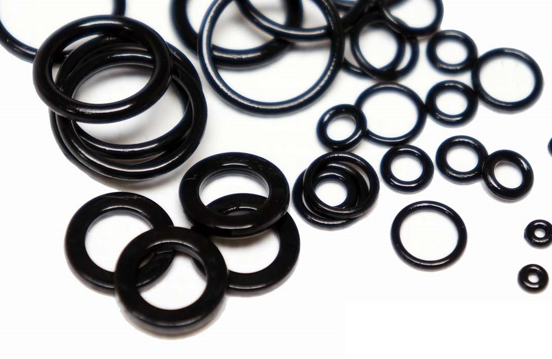

"O" rings plus 675 hearing aid batteries may work.
Here, O rings:
ZA675 hearing aid batteries:
There you go!

I tought it could be other "O" rings. I have tons of those at my house xD
