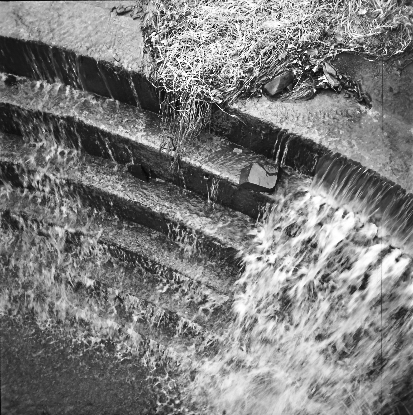

Ok so I used the BTTB with the Rollei Superpan and 1 of the rolls had a line that ran down the right side of the negative. It's on every frame. Any Idea what it is? Other rolls shot with the same camera came out fine. What did I do wrong?

May be the scratches from the rollers...
Sent from my Nexus 7 using Tapatalk
Not to ask a dumb question but I developed 2 rolls of film shot after this one and it wasn't on them. Is it a possibility it corrected itself? Or could it be something else?
How could I tell if it was something on the rollers?

A dust particle, or grain of sand, or whatever might have been inadvertently introduced onto the roller when loading that roll of film and then possibly blown out or knocked out upon removing the film or loading the next one. Happens from time to time. Sometimes a 35mm roll has something in its felt light traps that causes a scratch only on that roll as another example...
