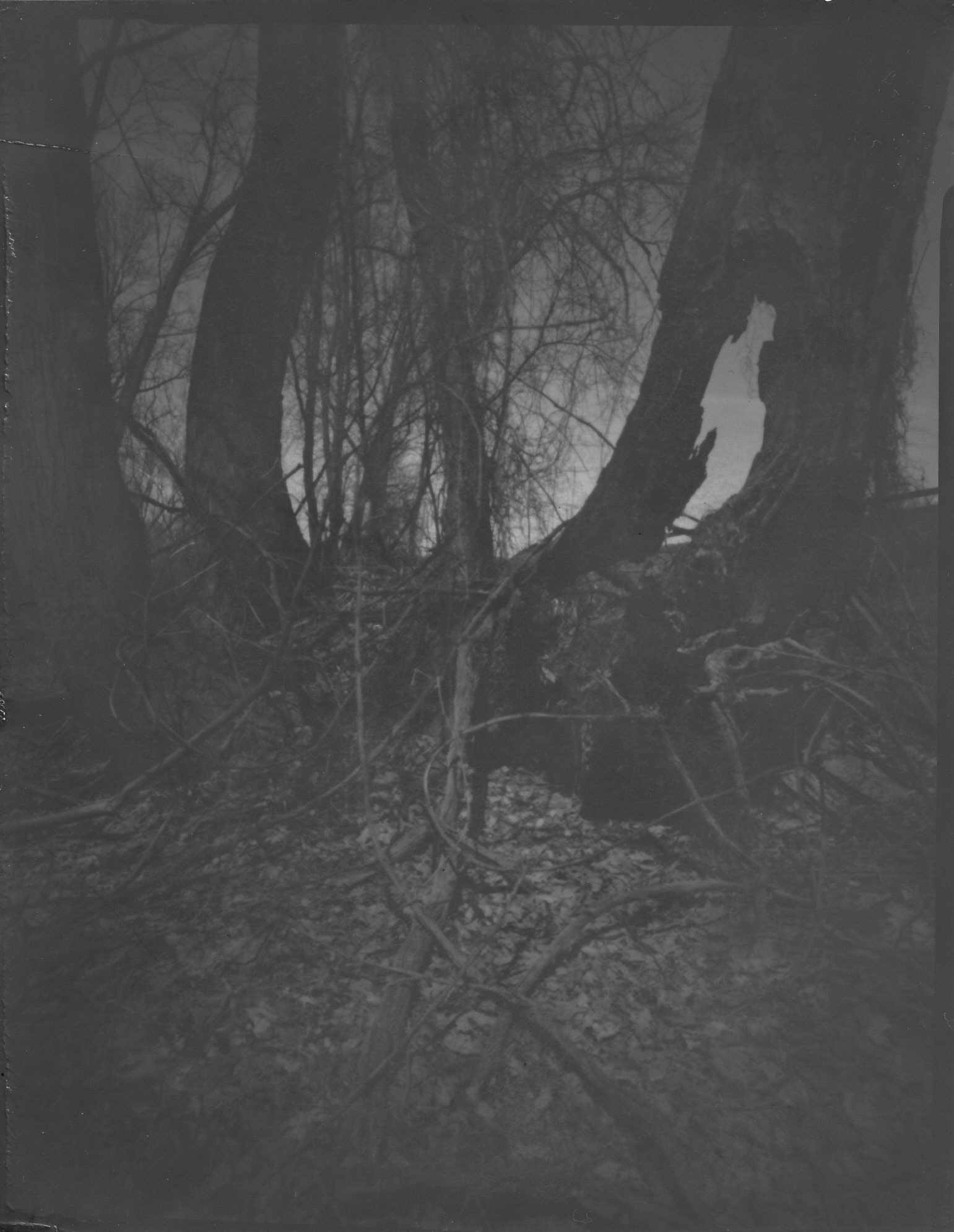

I know this is probably a dumb question and thing to do but has anyone tried BTTB as a paper dev? I used it from a pinhole shot I took on Harman Direct Positive Paper and it turned out pretty good (if you ignore that I under exposed the shot). I ran out of my normal paper developer and figured why not.
Sorry my scanner isn't the greatest.

I really like this image, underexposed and all! Not too contrasty, as this paper often is.
I will try Harman DPP in my pinhole camera too.
Bert from Holland
