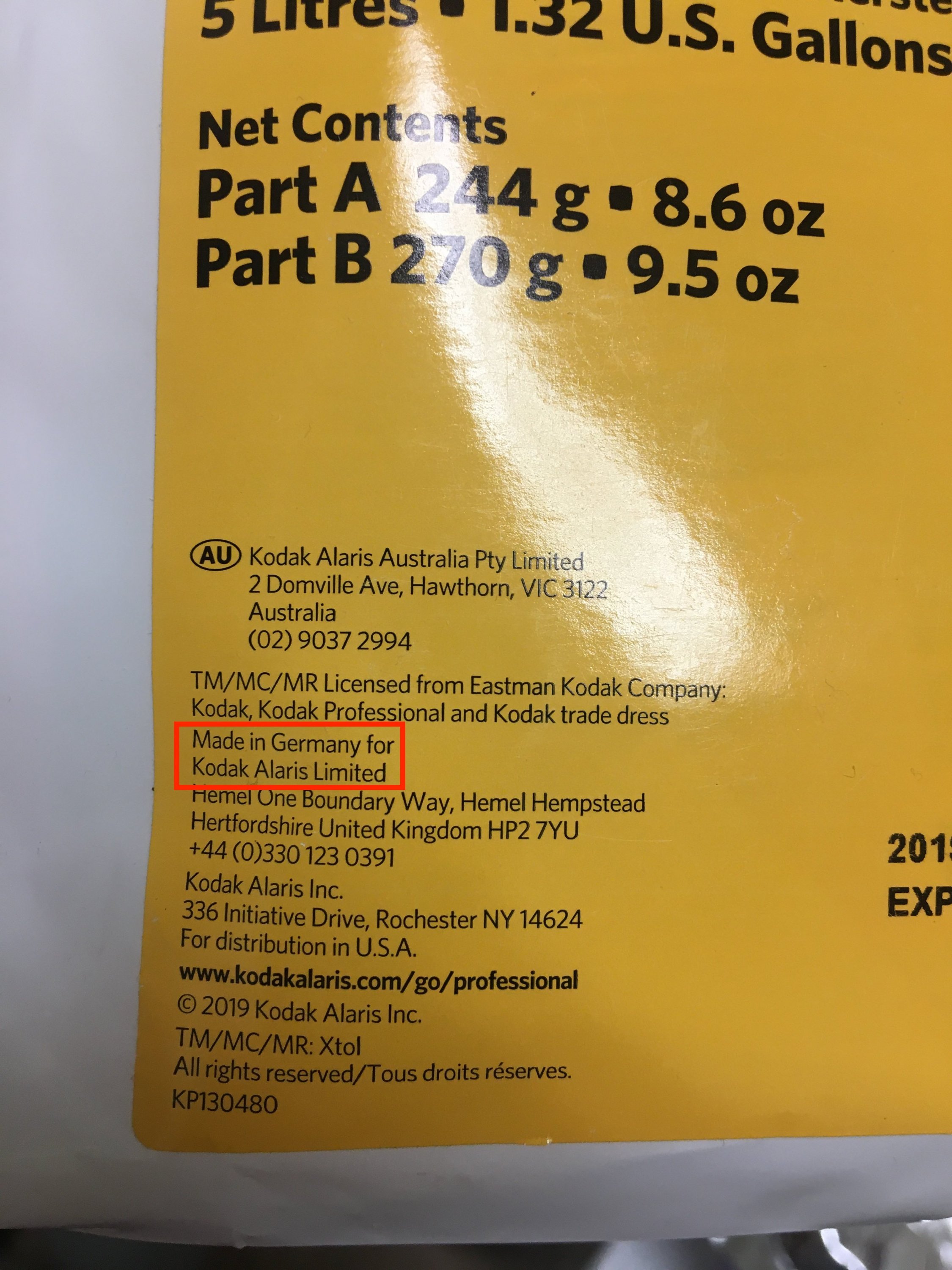

I hope we don't go "there". The batch of XTOL that went bad was actually made in Germany.
As will be any you buy in the near future - the fragmentary information I've seen indicates that the new packaging also says Made in Germany.
In practice that stamp says it was packaged in Germany, nobody knows where the chem came from.
