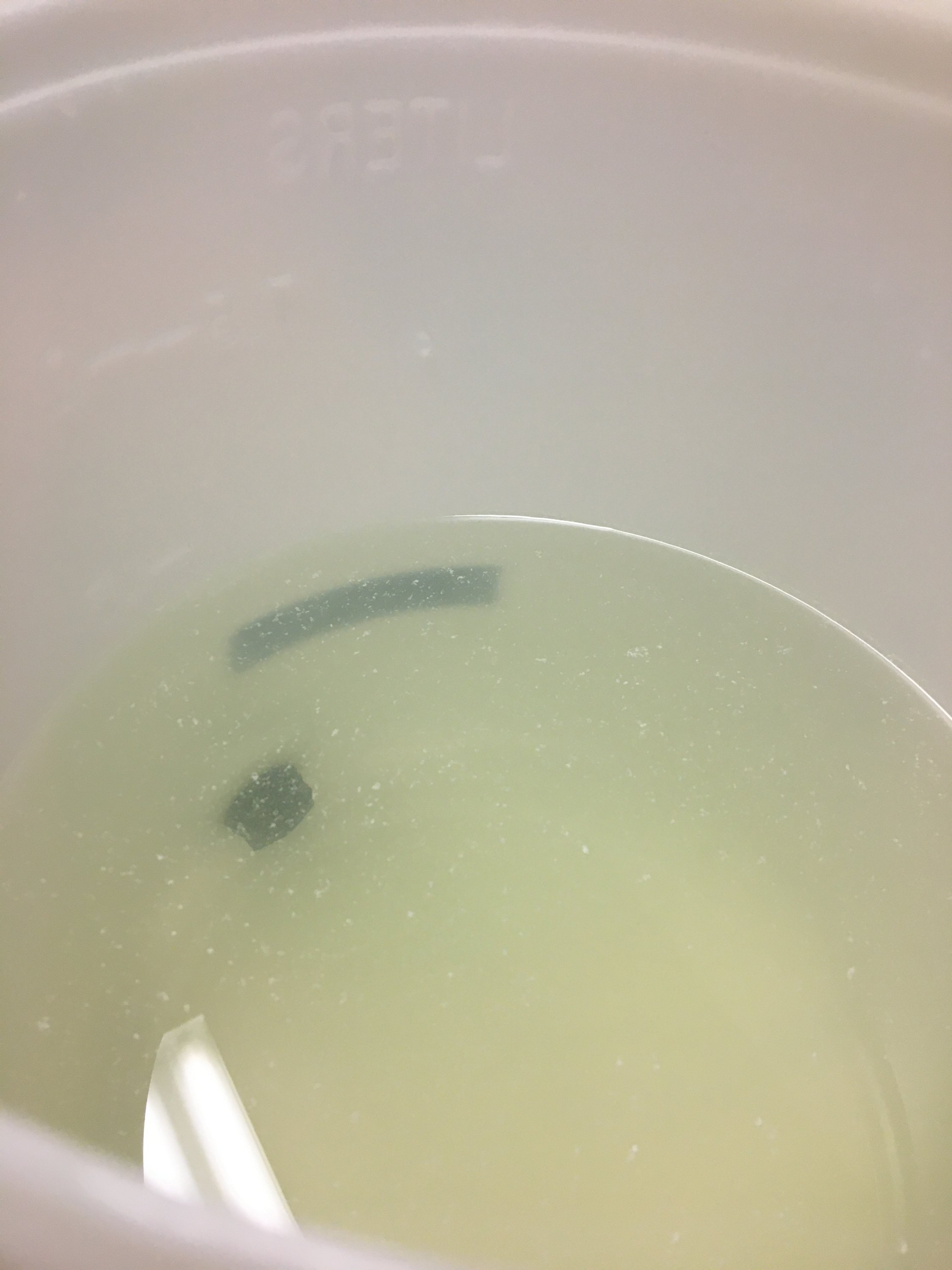

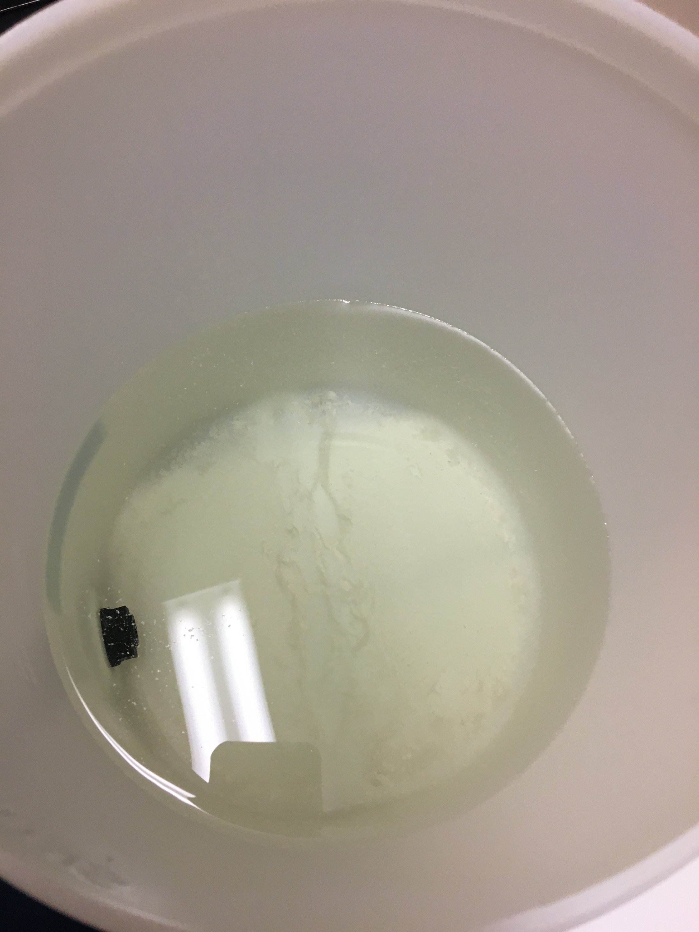

I just mixed XTOL and, it was made last year... "newer" batch, expires next year and I got a ton of floating things and the color is not what I remember it to be. Part A dissolved fine but left those little things floating. I mixed part B and still there.
I don't know what to do now

What colour was it? . I am a user of Xtol myself but my last mixing pre-dates the latest change. It certainly used to go to a kind of orangeade colour before turning as clear as water before being decanted into containers. If I recall correctly a few( very few) small crystals tended to remain in the water before adding part B but a quick crush action with the flat end of the plastic stirrer always dissolved them

Instructions for my 2002 Xtol specifically said it would turn orange when mixing part A, but would then clear when Part B was added (and it did). That's apparently exactly what you expect (I'll be curious to see if Mytol does that).
That said, I saw no "floaters" after mixing part A, but Xtol has changed manufacturer at least once between mine and a 2019-made package, and again since then. Also, because I didn't read the directions before mixing, I mixed in hottish water (above 100F, probably below 120F), so everything dissolved pretty promptly.

Still good, at least mine does that.
Check back in a few days to see if it has dissolved.

I just mixed a batch of Mytol, yesterday, and it didn't turn orange. I would say that it had a very slight orange(ish) / copper (ish) tint when fully mixed. Perhaps, mixing each individual chemical in separately avoids any noticeable color change?
It's kind of greenish and there are less of those particles floating. I remember XTOL being like water. Now, there are less floating particles but there are still there. I saw this, I'll contact them https://twitter.com/KodakProFilmBiz/status/1197212541753143297

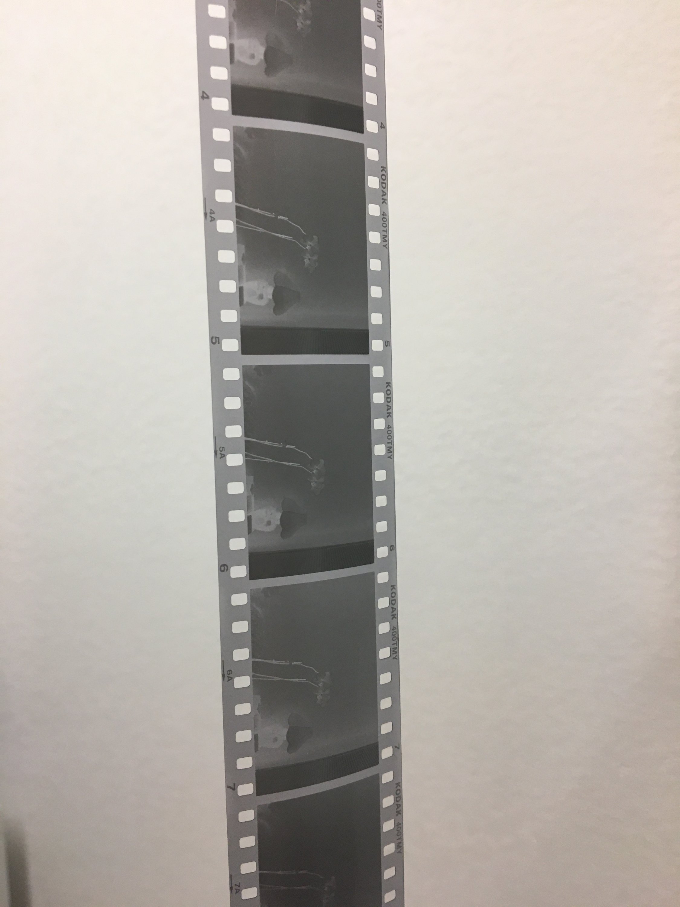

Also I used a coffee filter and did 1:1 and developed a roll. It's some tmax 400 from 2002, seems to be working fine.

Well certainly any shade of green is clearly different to it being the colour of water which the former Xtol was. Is there any mention in the latest instructions as to what Kodak expects the resulting colour to be?
It's good that it seems to have worked as it should and as long as it works then I'd have no problem with what looks like a slightly cloudy hint of green but certainly this kind of a change, if it should be as your Xtol is, needs an explanation from Kodak. If it is meant to be slightly cloudy with a hint of green then my only concern for the future is that in my experience the former Xtol as it ages does change to a very slight pale straw colour which is a useful sign that it is "on its way out" i.e. beginning to become exhausted. It would be useful to know what if any is the new sign of exhaustion

I found that when I mix Solution A the water must be warm and I must stir for a long time to get all the powder into solution [orange] before I add in Solution B [clear]. If I do that then I have no floaters. When I did have floaters the XTOL still preformed properly, but I had to be sure the film was rinsed.

No reply so far but I developed a roll of Tmax P3200 pushed 2 stops and performed beautifully so at least for now it's all good.
