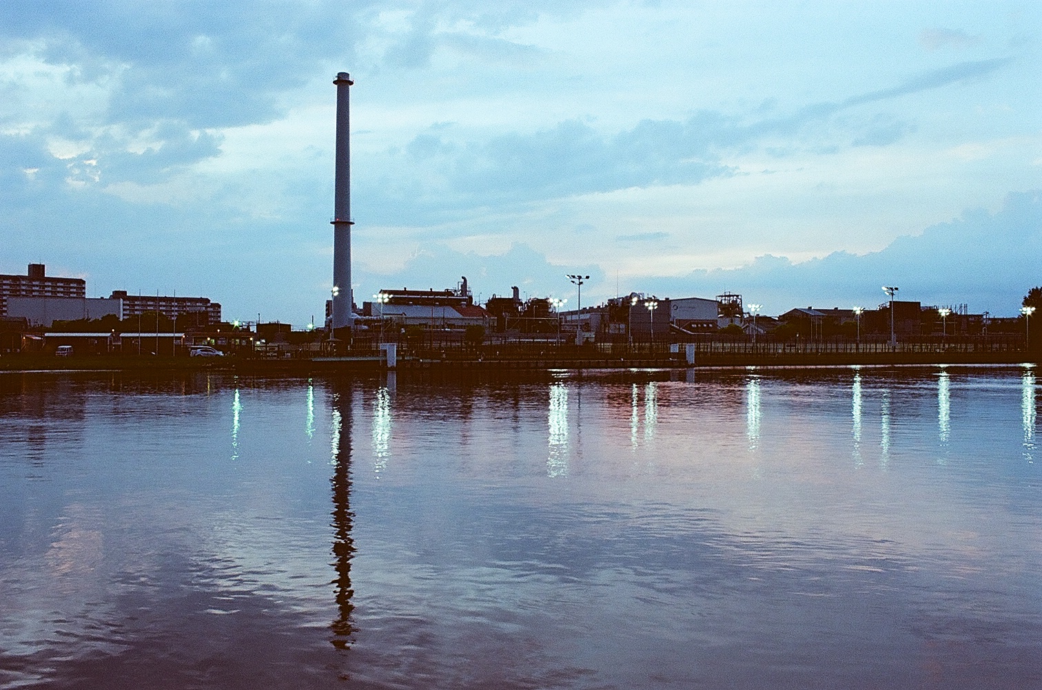

Going back to Tokyo soon, I would really like to shoot the city at night, to obtain some hazy cyberpunk neon sceneries, Blade Runner style (I know, this sounds a bit cliché but I still want to give it a shot).
Unfortunately, most of my previous attempts gave very poor results : they lack sharpness and usually have very poor colors...
On Zuiko 50/1.8, OM-20, about 5s of exposure, Kodak Portra 800

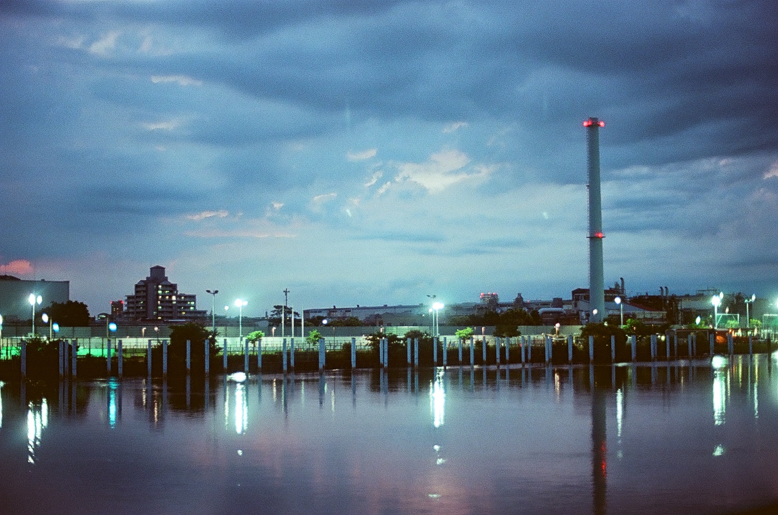

On Zuiko 28/1.8, OM-20, about 3s of exposure, Fuji Superia 100 (not sure about the model, but sure about the ISO)
My main question is : what seems to be the problem? Is it the exposure time? (I am guessing it arbitrarely and doing a bit of bracketting, since my camera doesn't measure below 1.67 EV with my widest lens). I saw @Sirius Glass link to the jiffy calculator, and will give it a try but I would like to have your opinion on whether the problem comes from the exposure or something else.
Thanks in advance
I see nothing wrong with the bottom two pictures. The top one is difficult to get right because of the bright highlights on the right and deep shadows on the left. Too late now but if you were to take the top one again you could either avoid the deep shadow area or if you were close to it then low level fill-in flash might be enough to bring out some detail. Alternatively you could place a graduate ND filter across the lens to where the shadows begin to level out the exposure effect and then increase it a little so you have slightly less bright highlights due to the grad ND and an increased brightness in the shadows due to increased exposure

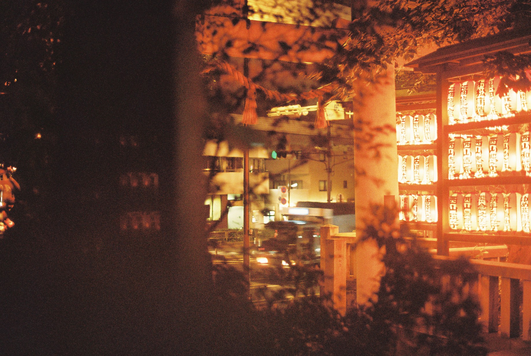

The photos below were on slide film, long exposure with camera on a tripod. The blurred ferry was deliberate as I thought the coloured lights might be interesting.

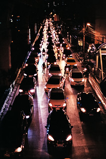

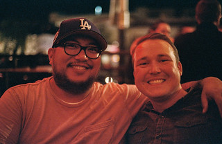

Pretty much whatever film you're shooting, open the lens all the way (f/2.8 or more) and shoot at 1/30s. You will get something decent. Of course at night 800 speed would be more valuable than 400 or 100. I use the same rule when shooting indoors too. Here are some examples I've shot that way:
Portra 400
Bangkok Traffic
Superia 800
Sherwyn and his buddy John

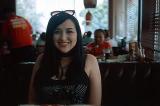

It looks to me like exposure is the issue. Generally you will get better results by overexposing and then printing the downward to get dark areas dark but still full of detail. You are starting with not enough detail, and when you try to lighten it up, there's nothing in the shadows to reveal--just grey emptiness. This is most obvious in the blank grey areas on the left in the first photo, but visible to all of them if you know what to look for. The other solution is to print what you have, but do it more in line with the original subject, which was dark, with large expanses of empty solid, pure black. You are trying, to some extent, to make night look like day---lighter than it really was Print down until your black areas are genuinely black..
There's a nice add-on for Chrome browser called Image Histogram. You can use it to show a histogram of web images. Yours stop considerably short of pure black, which means that in these photos there is no black at all--not even in the darkest areas without any detail. Certainly that is not the way night is!
I don't see any particular lack of sharpness. What I do see is a generally blah tonality which you may be interpreting as a general lack of crispness. That lack is more about contrast and snap than resolution.
Image 1 is overexposed in the highlights.
Images 2 and 3 look nice to my eye.
