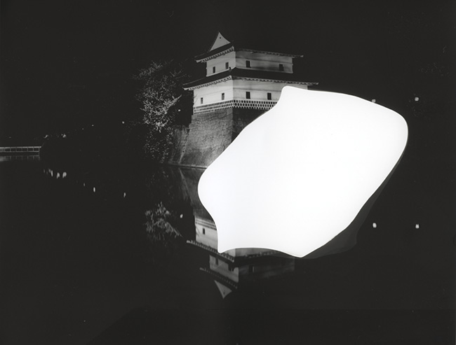

Hi All,
Just bought a box of Ilford MGIV RC, do to some testing. Still learning how to print, this is the second box of the MGIV RC I have tried. The first box was perfect no problems or any other issues. The new box was sealed and had never been opened.......
Last night set up the enlarger and made a few quick prints. Threw the prints into the developer and noticed something strange. A big white blob in the middle of the paper. Covering up to a third of image area. Looks like it was exposed at somepoint. Thought it might be a fluke, and I tried several other sheets from randomly from the box. All exhibted the exact same thing, though the shape of the spot changed slightly, it was roughly consistant through out the stack. The area around the spot was actually turning brown in the developer, in the fixer. While the unaffected areas where there normal color. I was using all fresh chemicals. After washing and drying, other strange effects are appearing. Things like water marks, and discoloration. Again, the other Ilford papers I have used have never shown this. Tried some other paper last night as well from a different box and it was fine.
Any ideas?
I know the box is bad, not sure if my retailer will take it back. So I may be stuck with a $70 box of bad paper. The other Ilford papers I have been using up until how are be great. Could be just a fluke, but still some what frustrating.
Thanks!
Gary

Can you scan a print and show us?
If the area is white then it has not been exposed - if it had been exposed it would turn black.
Check that the illumination on your baseboard is even and not dark in the centre with a negative inserted.
A test: take a fresh sheet out of the box and process it without any exposure: turn the safelight right down or cover it so as to rule out fogging from that source. It should come out completely white.
Test 2: Take a sheet out and close the box and turn the lights on so the sheet you just took out is exposed to room light. Process it (in the light) and it should go uniformly black.
If these look OK then the problem is probably somewhere else. If there is a problem - take the paper back to the shop and require a replacement. The same problem in the same place on each sheet suggests damage was done after the paper was coated - possibly heat damage from being placed too near a radiator.
Good luck, Bob.

A white spot means either no exposure, no development, or no emulsion.
I've had a box of paper that had a consistent coating problem - a 1" band down one side with no emulsion. I can understand how that could happen in an automated coating process - it's harder to visualize a coating problem that would result in a consistent pattern of uncoated areas in the middle of sheets. But I won't rule it out - s**t happens.
Contact Ilford. Be prepared to show them some examples. If it is the paper, they will do the 'right thing'.

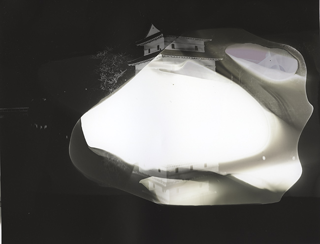

Hi All,
Thanx for the helpful replies. I know the enlarger is fine, because I made a print of the exact same negative on a different batch of paper and its fine. I attached a couple of examples. Please let me know what you think.
I am going to have to contact Ilford, the retailer at which I purchased the paper at is 600km from here, and I am not going back down there for a long time. (Small Mom & Pop place I go when I visit my inlaws, no web presence).
Thanks Again.
Gary

Gary -
A control test would be to take two sheets of this paper, expose one to white light and process it normally, and then process the second with no exposure to light. The first should give you results similar to what you are showing in your examples, while the second should be blank white.
Then, examine the blank white (unexposed but processed) sheet to see if you can detect any pattern in the surface that suggests that the emulsion may be physically defective.
Finally, look at the package to see if there is any evidence that it may have been exposed to moisture.
Based on your description and what you have shown, I tend to agree that the paper is rusak. Contact Ilford - our friend Simon here on APUG would be a good starting point and he's just an e-mail away.

It does not show up on the scan, but there are actually strange brownish streaks in the white areas or the prints. I am going to drop an email to Simon, and see what he says.

The edges of the fault on the second sample image are far too sharp for this to be the issue. Unless there is no agitation at all, those edges would be quite diffuse and uneven.
My guess is a coating fault.

To test for a defect in the emulsion, take a sheet in daylight and develop it to give a fully black uniform image. Defects will show up as white or light spots.
If the spot is uniform with the rest of the surface, that is, there is no depression, then the emulsion is there, but something has desensitized it such as water. A drop of water on Ilford MGIV will cause a white dot.
If there appears to be a crater or depression forming the white dot, then the emulsion is missing.
This test must be done on a sheet freshly out of the developer, and should be a touch test to feel for the depression forming the white spot.

A coating fault would not give the same problem in the same place on each sheet - paper is coated in large rolls and then cut to size. Whatever has happened almost certainly occurred after coating, cutting and packing.
I wonder if the emulsion has stuck to the back of the next sheet due to moisture? The sharp edges do look somewhat as if the emulsion has been ripped off!

Thanks for the replies, very interesting reading. I repeated the test last night, including taking a couple of sheets exposing them to room light for a few minutes then developing them. Pretty much the exact same result, big white blob pretty much in the same place.
I think at this point its either a coating error or the paper was exposed the moisture at some point. The box has no signs of water damage at all, though the paper it self was a little sticky when first opened. I wonder if at some point when it was packaged if moisture didnt get into the bag?!?!
