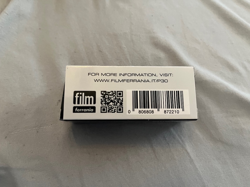

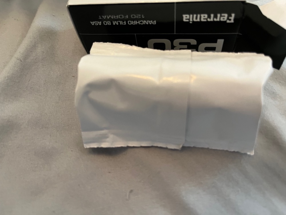

I don't know if Ferrania is packaging the 120 themselves or outsourcing, but their packaging looks a lot like Foma packaging, and it is real, not vaporware:
This looks like Foma here:
And this as well. Many of the Foma rolls I've used use tape here that is adhesive all the way around like the P30 roll, and the very end is folded over a little crooked as you can see in this shot:

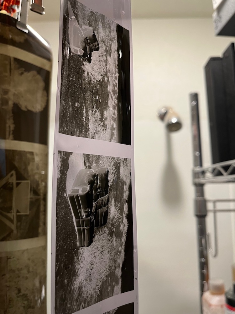

FYI, the edge printing on the film only has the letter P then 4 inches later the number 30, then 4 inches P and so on. You can see the P in this shot, but not the 30:
That's because you hung the film up vertically, to dry. The 30 slid down from the P... 😄

BTW, thats PyrocatHD. I don't see much stain, especially compared to the Bergger Pancro behind it. I haven't seen any other times for Pyro, so this was a wild guess of 18min at 1:1:100, 20C, with the film shot at EI50. I'll have to scan in a few days to see how it looks.
I got good stain with Pyrocat-HD 1+1+50 with the very first roll of 35 I shot a few years ago... The film was quite underexposed though, as I exposed it at box speed... EI 32 for the next roll was much better. Stain was good.
The bergger mostly seems to have a pretty massive amount of fog, mostly comprised of dye. There's something in that film that really seems to trigger (excessive) dye formation from the pyrocat developer. It suggests that most of the color you have on those negatives is not image-forming dye.
Is that P30 negative shown here slightly underexposed, but a little overcooked? Looks like it to me...?
Certainly possible. I exposed that visible shot at 1/250, ƒ8 which makes the EI about 50 on a bright sunny day without a cloud in the sky @ 11am. I didn't have a meter with me so I was guessing all my exposures. I chose 18 minutes fro dev time because most of the other P30 times I saw with other developers seemed to be a little on the long side (except HC110B whis is listed at 5 minutes). Since average time for other films in PyrocatHD seemed to hover around 12-14 minutes, I rounded up to 18 for my first try.
(and yes--Bergger Pancro always has more base fog that any other new film, and so even the unexposed parts of the film turn brown in PyrocatHD. But when I dev Tmax 100 in pyro, the image area also has more noticeable brown stain that what I see on the P30.)
I'll probably try to scan a few frames tomorrow, but the shadows all still have image in them (notice the shadow cast by the sofa in the lower frame) but the bright areas may be a bit over done.
