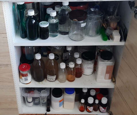

This is a tiny fraction of the chemistry I have. I have several more crates in storage. I have a vague idea what I'm talking about, and that's the basis I'm using for my nuances to your in principle sensible suggestion to be creative.
I've also advised and coached many darkroom workers in the process of obtaining chemistry that was/is sometimes hard to find. This goes so far as sourcing directly from manufacturers in East Asia, but for the most part consists of exactly like you said creatively making use of whatever is available locally in the form of household products.
I have also witnessed over the years how suppliers pop up and disappear at the drop of a hat, and legislation meandering (usually becoming stricter), causing stuff that used to be totally normal/regular to disappear from the shelves overnight and without as much as a notification being posted on obscure chemistry forums. I've also participated in enough exchanges internationally (some of these you can find here on this forum) that revolved around the various ways local markets differ, and the sheer impossibility of accurately assessing the availability of chemicals in a place you can't actually root around in for a couple of days/weeks.
Moreover, I'm fairly well aware of the average chemistry knowledge and interest of darkroom photographers. The harsh reality is that many of them are absolutely unwilling and unable to do the things that you and I may consider all in a day's work. Sometimes with decent reason, sometimes due to (IMO objectively) odd/irrational reasons. The number I'd trust with making noble metal salts in my circle of friends and acquaintances is limited to less than a handful (one of them has in fact done this, but only because he has access to an exceedingly well-equipped lab and is working in the field of biochemistry, so he has a good idea of what he's up against).
Based on all this, I have objections to your idealistic picture of "oh just let's be creative, there's always a way". There is often a way, and being creative/resourceful definitely helps. There are still limits (some soft, some hard) and risks (some tolerable/acceptable, some objectionable). Pointing these out isn't 'censorship'. It's common sense.
