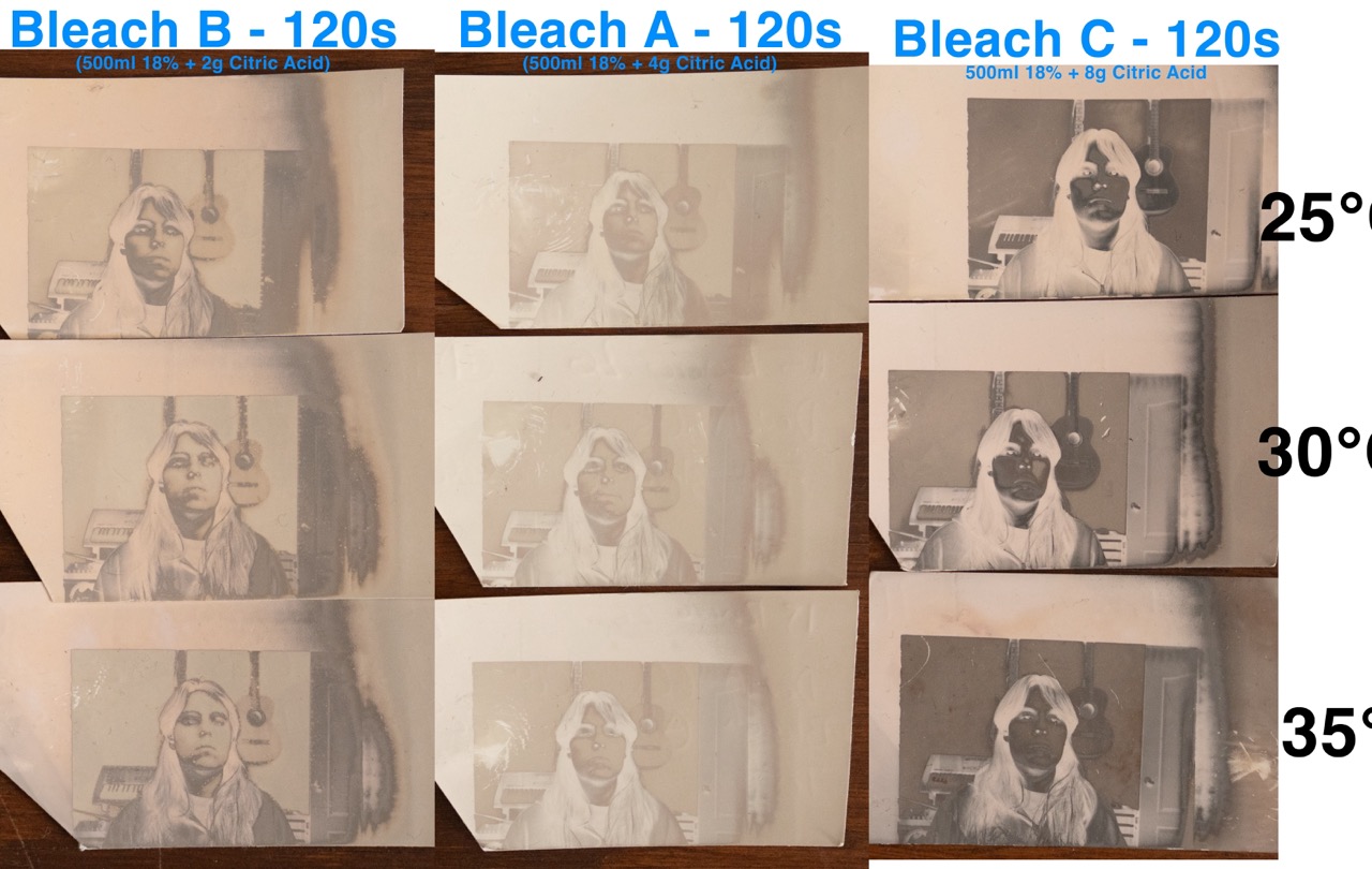

Hi!
Chiming in with a basic question: Are you guys doing all this processing at room temp? Especially the redevelopment in the thiourea mix.
Might as well try myself but still waiting on the thiourea to get shipped and wondering if I should get a sousvide or similar.

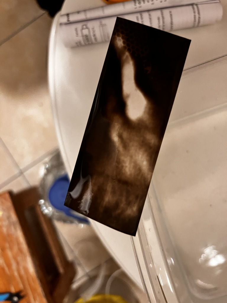

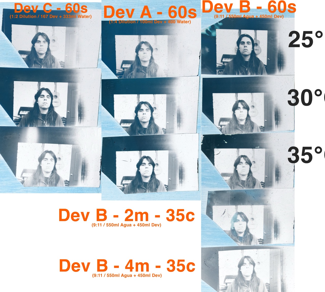

As someone that is interested in this process please do update us once you try. It seems to me that even if this process can’t give you maximum dmax it should result in positives that have their own look. Plus, they would probably be easier to scan than the super dense versions many people aim for.
Unfortunately, I was out of home during the holidays but I'm currently getting back to it. My first 2 test were terrible failures but I did do them in a rush before I left. However, for my formula I'm trying to use a peroxide based bleach instead of the classic permanganate/dichromate bleaches to make the process safer, but I'm not sure (or can't recall) if someone has used this 2 chems together for reversal, most peroxide bleach reversal are done re-exposing with light, so this might be my point of failure. Also note that this is my first time doing any type of developing, so I'm sure that doesn't help either.
one of my test strip failures, this was supposed to be a portrait.. .
Reversal processing as your first foray into developing? Brave! There’s more to go wrong with classic reversal processing so it’ll be harder to figure out what’s going wrong. If you keep posting your process and results you’re sure to get some help here.

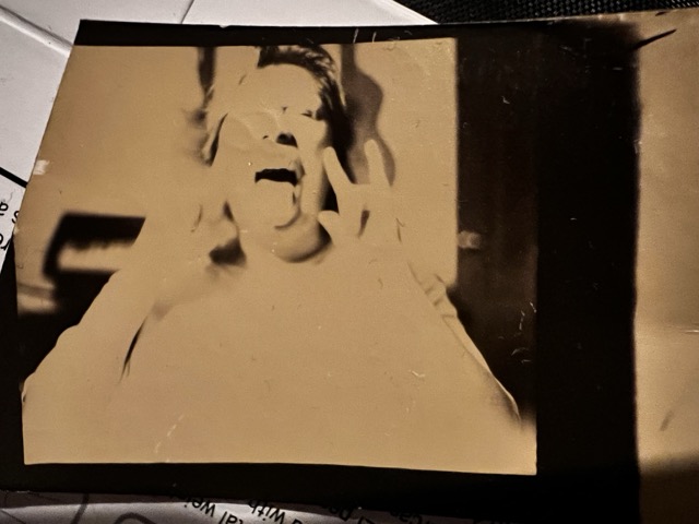

FIRST SUCCESS... Sort of...
Managed to get this image
Incredibly contrasty and possibly overexposed?
Interesting tint, a little more aggressive than I would have liked, but I know thiourea is a sepia toner after all.
The formula:
At room temp (20c)
Dev Ilford RT2000 (1+4 Dilution) - 60s
Stop Bath (480ml Water + 20ml Vinegar) - 30s
Peroxide Bleach (500ml 18% + 4g Citric Acid) - 120s
Water Bath - 60s
Thiourea (16g Sodium Hydroxide, 2.5g Thiourea, 500ml Water) - 60s
Accidental second Bleach - 30s
Was working in total darkness as my paper fogged under safelight, so I mistakenly dunked it in bleach again in the end...

Whoops! I hadn’t read back on the thread. Didn‘t realize you are doing paper reversal. Which paper are you using? If it is MC you can try putting a yellow filter on the lens to help reduce contrast. What safelight are you using? I can’t think of any papers that should fog under OC or red light these days. I have been out of the loop for quite a while though.
