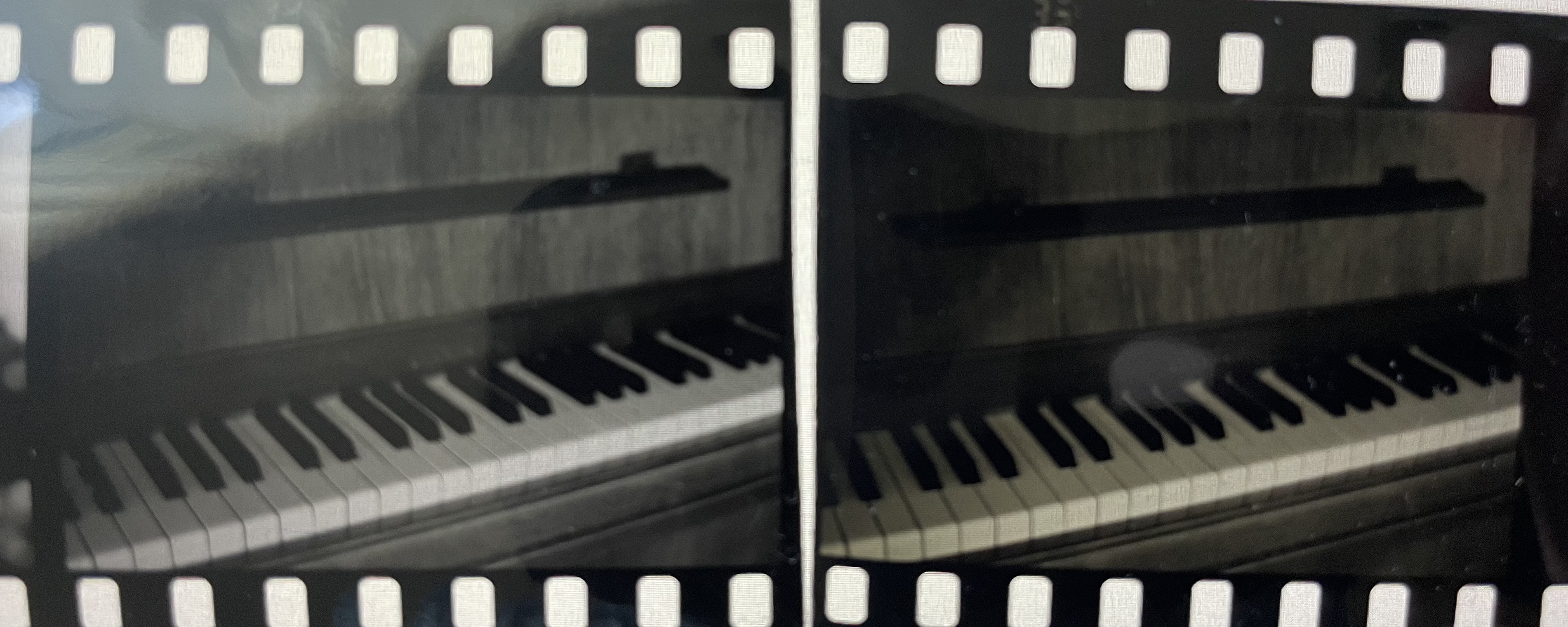

Do you fix when using thiourea as a fogging developer? I found it necessary to fix when using dithionite.
Theoretically no, as long as the fogging+redeveloper is done to completion. But you safely use a 1+9 diluited rapid fixer for a couple of minutes just to be safe. It does no harm at all.
pkr1979
Jun 25, 2019
567
Oslo
What exactly do you mean when you say "I found it necessary to fix when using dithionite"? Did you measure and find out any difference in density before and after fixing?
On the 2 last frames of the roll I shoot the exact same photo, with the same settings, in the same light. Before fixing cut off one of them while fixing the other. They were quite different:
IronOut (dithionite) for 6 minutes. 4 initial inversions and 4 more half way (about 20 degrees). The one at the left is fixed.

I also once fixed a 120 slide after getting a tip on that it should be done, even when using dithionite. That also changed density. Back then I tid agitate 10 seconds every minute with Iron Out too.

How does this differ from a 'regular' reversal process where you use light and a regular second developer? I will say that fixing after Iron Out does improve the overall image. And the one example here, as you can see, also changed tone in addition to density.
Very fine silver grain can impart colour to the image. But I am not sure that's what is happening in your case. Though the slide looks slightly better due to lightening, it appears that the density in the unexposed areas also reduced after fixing and thereby reducing DMax substantialy. Only you can tell for certain as observations made from a phone snapshot might not be accurate.
I have not had problems getting very clean highlights with Dithionite as the second developer unlike the results you shared above. But the films could be different and Dithionite I used was not Iron Out.
Years ago I did the same testing with Ilford Reversal just to see for myself through an experiment what happens. So I reversed the film up to Fix stage and cut my film in two: 1/2 gets fixed as usual, but 2/2 skips the fix stage. I observed similar behavior - very noticeable differences in image tone and DMAX.
Unfixed slides look very warm, are denser and extreme highlights aren't really clear to the base, but the look is completely passable if not preferable.
Fixed slides look way more neutral and comparing to unfixed - loose some DMAX. Which is completely fine as the reduction of density can be accounted for in the 1st development stage.
Based on my testing and my use case where film gets blasted with tons of light and base-bending heat during projection (torture) - I strongly disagree with the claims that slides can be left unfixed. I deem such an idea quite irresponsible for long term storage/use, because projected slides get that much more abuse compared to negative which just chills there and waits for occasional soft enlarger or scanner light.
If there wasn't anything for the fixer to do, the image wouldn't change at all, right? But it does and quite drastically. So I fix every time and get a solid DMAX nonetheless.
