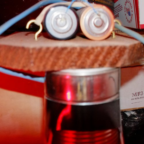

I ordered this 15w bulb http://www.bhphotovideo.com/c/product/122015-REG/General_Brand_15A15CL130_Lamp_15_watts.html as recommended to use when contact printing in this instructional: http://users.rcn.com/stewoody/darkcam2.htm but it didn't mention using a filter (they were using graded paper)
I'm not sure whether the filter will be circular or rectangular, or even if I have it yet(my friend is getting back to me) so I may need some help to acquire one w/o buying an entire set. If its rectangular, I'll probably just masking tape it over the opening of the contraption I come up with.

Ha! No, it was really "jury rigged"... I soldered the wire to the bulb and just stuck it through a hole punched into the bottom of the can. I threw it together very fast, but it worked just fine and I used it for maybe a year.
I'll go and look and see if it is still in my closet ( aka "darkroom" ). If it is, I might be able to take a photo. It really was just as simple as it sounds... get the juice to the bulb with a way to turn it on and off in the dark.
Back in a few minutes!
OK here are some crummy photos. The first is the bean can looking up toward the ceiling of my closet. I'm holding the switch, which normally hangs down to where it can be used conveniently in the dark. The second picture ( holding the camera over my head and guessing -- sorry about the blur! ) shows that the batteries are on top of the wood held in place with cup hooks and rubber bands.
You can see the cardboard "shelf" which allows me to put a filter under the light. Also, there is only one hole punched in the can, on the side. I threaded the wire through it and soldered the light bulb to it. The bulb is just suspended in air near the top of the can... it's not held in by anything except the stiffness of the wire.
So, like I said, ugly and thrown together, but it actually served it's purpose for a long time before I got my enlarger. The cardboard is just held on with duct tape.
