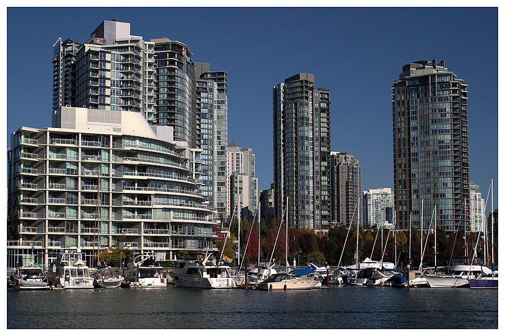

This was taken in summer, but I doubt that it answers your question:
(It is one of the Moderation team at work - and yes, I missed focus!)
If what you want from the your summer photography is colour, and that is a not an unusual thing to want, then black and white film isn't appropriate.
Which brings up the most important question - What is it you want to create with your photography?
If what you want is more like this image, then the colour may be important
The unfocussed-ness of the image, blends me nicely into the scene. 😁
