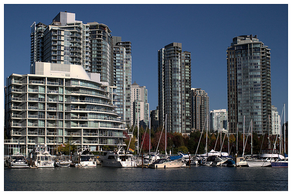

If what you want is more like this image, then the colour may be important
