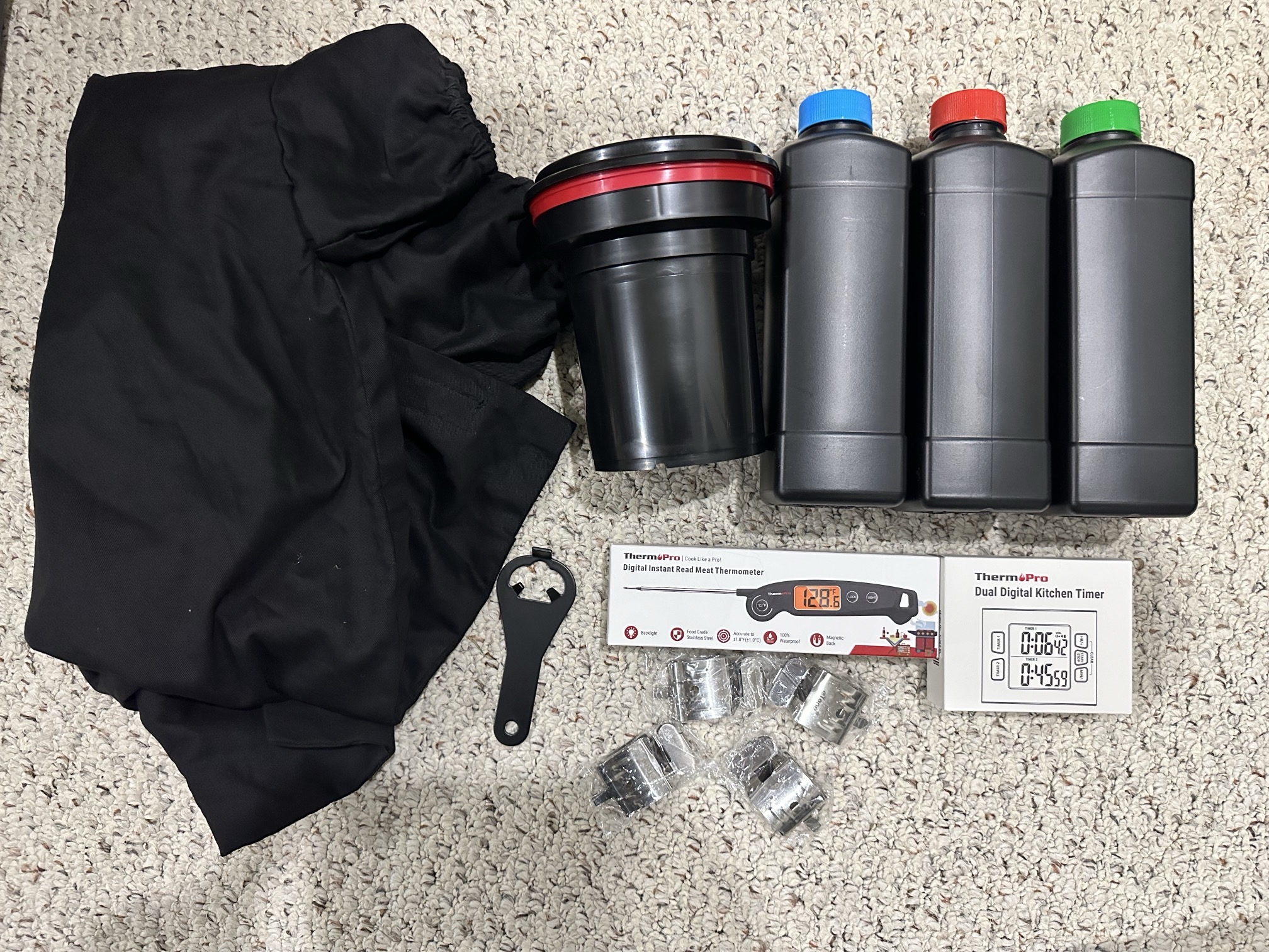

Hello all! I am about to jump into developing at home. I am going to do color and black and white. I will start with B&W since based on some research and talking to others it is a little bit easier to do than color.
I have a picture attached of my equipment and need help/advice on what other equipment is needed.
Here is a list of what I have
1. Patterson Dev Tank
2. 3 - 1 Liter bottles
3. Digital timer
4. Digital thermometer (probably only need for color?)
5. Film hooks
6. Changing bag
7. Film canister opener
8. not shown - rocker blaster
9. not shown - antistatic brush
Additional equipment
Do I need a film drying cabinet?
Something I was looking at for the dev tank is the Hewes Pro Stainless Steel Reel. I hear that they are much easier to load compared to the plastic ones.
But it looks like they only make 120 reels for Paterson and I would need to get a Jobo tank see link #3 below if that is a good tank. I figured to get one that can do at least 2 rolls unless it's recommended to get a smaller or bigger tank.
Things for me to buy now
(if people think the Hewes Pro reels are worth it over plastic)
1. https://www.freestylephoto.com/150135-Hewes-Pro-Stainless-Steel-Reel-35mm-for-Jobo-1500-Tanks
2. https://www.freestylephoto.com/1500...eel-Reel-120-for-Jobo-1500-and-Paterson-Tanks
3. https://cinestillfilm.com/products/...reiR9i4PC5cVUtO6yGIXtF5-mNQVVWX1HxvSHkpJlGdUB
Anything else that I am missing? should my bottles be different? Do I need funnels and other accessories?
Developer
What developer should I get? I did some research and people were recommending Kodak xTol. I mainly shoot Ilford B&W for now, but have a few rolls of Kodak Max as well.
If I need to split the equipment list from the Developer question let me know.
Thank you in advance for your help getting stared on my developing journey!
