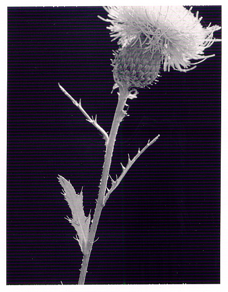

I used to generally agree with all that has been said above about Azo, contact printing and so forth until I took this one. The scan is from the test shot I did on Polaroid Type 664. Please don't try to judge the 3-D effect by this crummy scan, but believe me, on the actual Polaroid print, its there. I also did the full frame 4x5 shot on both Ilford FP4 and Efke 25. Not only that, but I also shot both films with two different lenses; my 12 inch 1940's vintage Commercial Ektar and a much newer Schneider 12 inch Xenar. I see the 3-D effect on all of the prints; polaroid, 4x5 contact, 8x10 enlargement, and 11x14 enlargement, all made on Kodak and Ilford multi-grade papers. So I dunno, the mileage varies greatly, but can be obtained seemingly irregardless of the materials in the mix. For me, that throws it all back to the lighting, contrast, and subject.

I'm curious. What was the actual diameter of the lens opening? Not the f-stop, but the focal length divided by the f-stop. How does it compare with the width of elements of the picture that define relief? (Of course I'm crazy. You all knew that.)

Don't forget that these were all LF camera originals, right? 4x5 will give you both micro and macro contrast scales in one image as I stated above and is probably one of the factors in this.
I see a lot of lines in this particular scan though that confound my interpretation if any is really possible on-screen.
Pat, all of this series was shot with a 24 inch focal length and an indicated f/22. That puts the ration at 24/22 or 1.09 which is 1:1 rounded off. There were two different shutters involved also. The Ektar lens is in an Acme/Ilex 35 (1940s vintage again) and the Xenar was in a modern Copal #3.
Because I no longer have the subject plant, I have to guestimate its dimensions from memory. The stalk was no larger than 1/8 inch, the head was about 2-1/2 inch diameter. The leaves probably about 2 inches long at most.
And, as Ron points out, these were framed and taken with the 4x5 format. The thistle's head was cut off by the smaller Polaroid 664 frame size. The 4x5s show the entire head.
Yeah Ron, that's my crummy scanner. It really sucks when there's a black background.
In this case, Alex, I think the main factor would be the backlighting, which causes the flower to separate nicely from the background, and then the fact that you're looking at a Polaroid with no enlargement or reproduction quality loss enhances the effect created by the lighting.
Interesting. I took the lighting as high, top right and slightly in front of the flower. Maybe just a hair.
PE
David, Ron, you're both right. This was done with natural sunlight where the sun was very high and to the right, strongly backlit but with just a small amount of front lighting. And this is the crux of my point - getting the 3-D effect is not dependent on the paper, lens, film or any of that stuff.
In the example you are showing, the 3-D effect is created by the shadows. If your lighting is OK, and in the exampele it is OK, you can use any photographic procedure. [ in computer games this kind of 3-D is being used]. In the case of landscapes, 3-D has a different origin ( the physics behind it is different), and therefore that will be another story.

The reason I asked about the lens opening is that it is possible for a lens that is wider than the subject to see part of it that cannot be seen from a single point. A little ray tracing will show what I mean. I have only done the imaginary ray tracing, but you can imagine a ray that is tangential to a small round object entering the edge of the lens aperture. It will come from behind the surface you could see from the center of the lens. Such happens with binocular vision when the interocular distance is greater than the width of the object. Each eye sees part of the object that the other cannot see. The brain integrates the two images. It's just a thought.
Printed on a flat surface though, this type of imaging has (to my eye) been somewhat distorted. Like using a wide angle lens without barrel distortion in a way.

Any backlighting would be emphasized by a wide lens opening. It would show at edges as a bright outline.
PE
You are right; this type of imaging on a flat surface is a distorted image. The distortion is described with methods used in projective geometry. It has no relation with 3-D effects with subjects nearby. That is determined by the shadows. Students in photography academies had to light and photograph an egg, to learn the tricks that an egg looks like an egg.
Alex, Jed;
My experience would make me agree with both of your comments.
Alex, I would alter your words above slightly as follows "the 3-D effect is not entirely dependent on the paper, lens, film....." as I feel that there are other effects such as I described from Kriss' work and the subjective factors that have been discussed here. Of course your "any of that stuff" takes it in, but the word "entirely" takes the onus off of any one factor and leaves the solution up in the air, as it really must remain. Just a thought. Many good points to ponder though.
