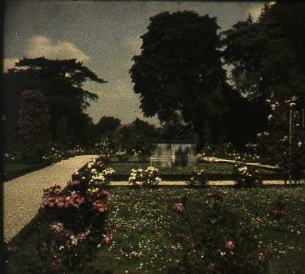

Photo Engineer
Apr 19, 2005
29,018
Rochester, NY
The currently posted Autochromes lack density, contrast and color saturation when compared to the original Autochromes that I have. They also lack the distinctive grain pattern evident even viewing an original Autochrome by eye.
The first 3 can be attributed to the silver quantity coated, the lack of the black pigment grains, and perhaps spectral sensitivity or dye quantities used. The second item may be attributed to the resolution of the scan, the fineness of the silver halide grain or the size of the starch particles.
As you see, there are too many things to ponder here to sort them out just by this simple viewing over the internet. The appended photos are the original box of stereo Autochromes that are in my posession and a scan of a 6x6 singlet from a pair that pretty much duplicates what the eye sees in terms of color and grain.
PE
Mustafa Umut Sarac
Oct 29, 2006
4,918
İstanbul
Ron , Where can buy from such a exposed plate ? Are they very expensive ?
Photo Engineer
Apr 19, 2005
29,018
Rochester, NY
I have seen plates like this and up to 5x7 in the price range of $20 - $60 US. They are rather common at photo shows which is where I picked these up.
One of the most beautiful was a 5x7 plate, a portrait of a young girl circa 1920 or so. Very beautiful. Of course, the grain appears to go down as the size of the plate increases.

Mustafa;
The color range in that photo is so limited, it is difficult to evaluate. The grain is exceptionally fine though. You should read the treatment of "grain" in this type of system in "History of Color Photography".
As for my slides, they are a complete set. I don't want to break the set.
