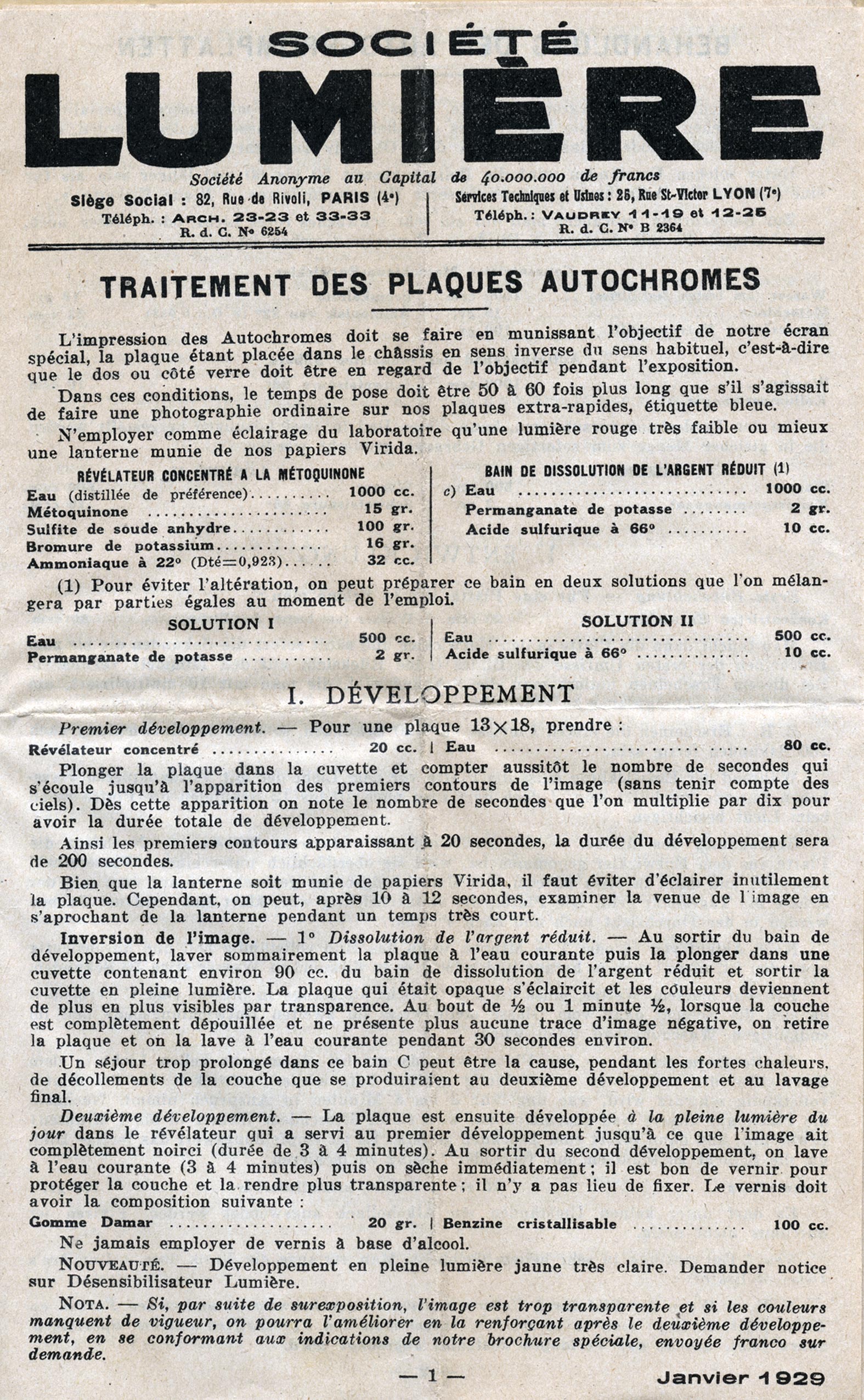

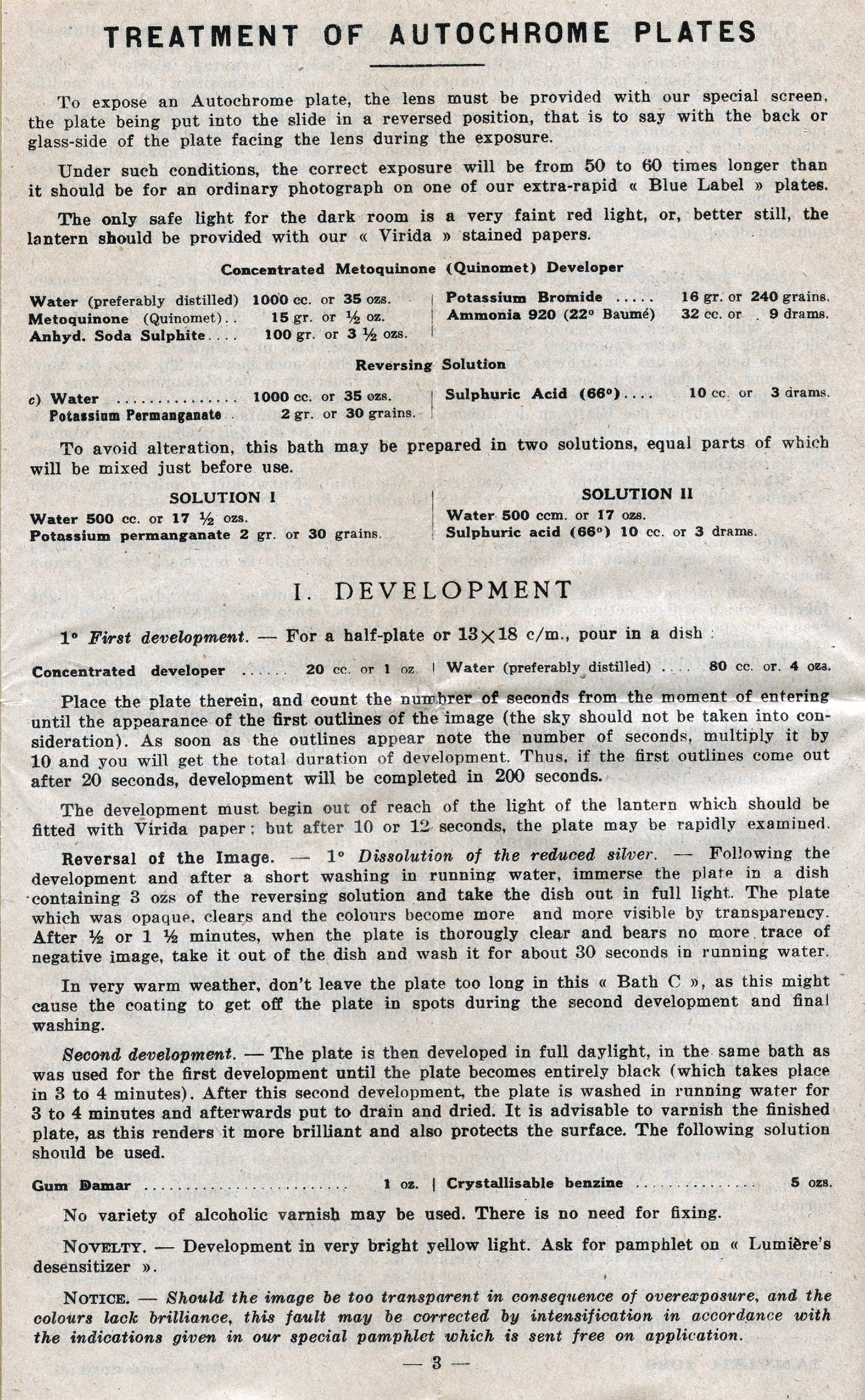

For the benefit of the curious, here are the instructions that came inside a box of Autochrome plates.
Anyone have the other pamphlets mentioned in this text?
