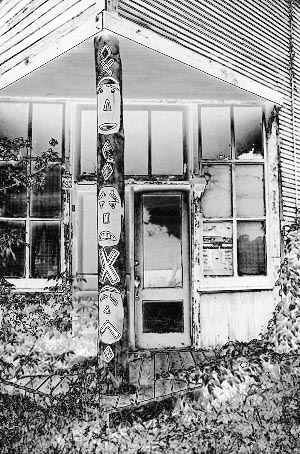

Well, I've developed my roll. A sample, you'll need to view it large:
Notice the solarisation. Very disappointed with a film which I worked hard to expose correctly, were extra dilligent with cleaning (Water, Toothbrush, Water, Tetenal Exargent Silver remover, Water, then finally use) and very careful to follow all guidelines the development process - including using distilled water
I've uploaded a 3200 DPI Scan so you can see the pretty much grainless image with plenty of resolution. So if there wasn't something wrong with the development process this would be a very good combo.

I was wrong about the cause before, and I am sure I can be wrong again, but here goes:
It's doesn't look like solarization to me. In solarization the HD curve turns back on itself, and the blacks become whites if the print is solarized or the whites become blacks if the negative is solarized. Examples to the left.
This looks to me like posterization, where a range of grays instead of being smooth are represented as a small number of discrete tones - instead of a 100 greys the photo only has 10. Examples to the right.
I'll take a WAG and say it is somehow related to quantized grain sizes in the emulsion. The emulsion contains a mixture of grain sizes but all the small grains are the same size, all the medium grains are the same size and all the large grains are the same size.
It is possible the effect comes about as grain size equates (first order) to film speed, and each emulsion is lithographic: either fully developed or not developed. The small grain emulsion (slow) may have many grains and can achieve a high density and the large grain emulsion (fast) is sparse and can only manage densities suitable for shadow details.
This may have come about by trying to make a continuous tone emulsion on a microfilm manufacturing line. Lithographic film and microfilm owe their high contrast to uniform grain size. If batches of emulsion were made with uniform grains, each batch containing a different size, and then blended together this may explain the effect.
Technical Pan, by this logic, had a true continuum of grain size. I never had it posterize.

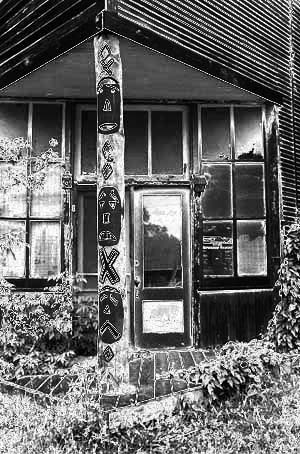

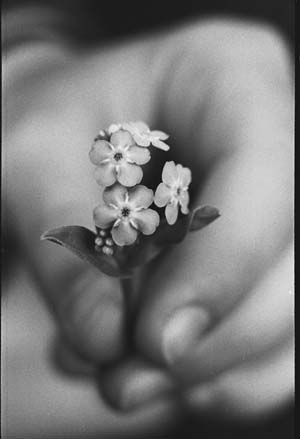

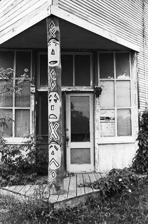

As you might have read in the previous thread I shot some ATP and developed in HC110 and Rollei RLC. Did the same with the Kodak TP.
Something strange happened with the TP and ATP in the RLC developer and I'm not sure what it is. It looks like some sort of liquify-photoshopfilter applied in the unsharp parts but it's in the negative for sure. I first thought with the TP that it had something to do with its too short development but then I noticed the same thing to occur with the ATP as well... I really can't explain it.
First batch:
ATP & TP developed for 6 minutes in Rollei RLC. ATP treated as a 40 asa, TP treated as a 25 asa. TP really underdeveloped so the contrast has been a bit enhanced in photoshop. I think it will be quite printable though as the "effect" looks pretty cool to me so I'll definitely will give that a go.
ATP has not been photoshopped except for dust removal and I made the landscape photo a little darker.
Second batch:
ATP and TP developed for 5 minutes in HC110. Same asa values. ATP a tad overdeveloped as I lost some detail in the highlights. No changes in photoshop except for dust removal.
The grain seems with both films a lot less when developed in HC110 then in the RLC but maybe I did something wrong...and I'm looking at scans...
