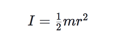

In the 1980s I was shooing some slide film for a magazine article on a vintage race car. I had my Rolleiflex SLX on a sturdy tripod but did not have my electronic cable release (and was unable to pre-release the mirror). I used 1/30 second (Kodakrome 25) All the images had slight motion blur :sad:
Years later, around 1999 I attached the pistol grip, the massive 40mm Distagon and heavy viewing prism. With that setup I shot a body of B&W work at night at 1/30 and they came out fine. So, increasing the rotational inertial mass around the mirror swing axis helps.
