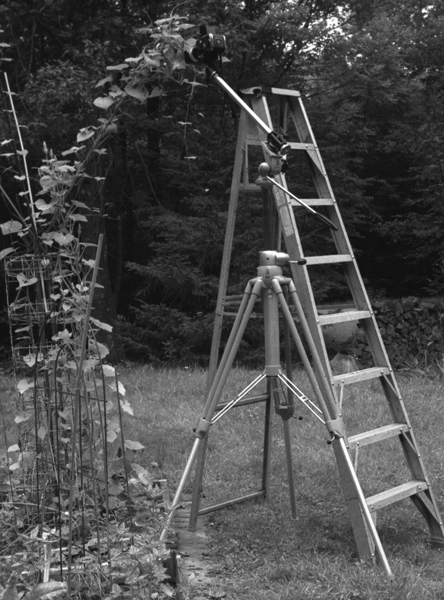

This photo was made about 10 feet in the air, I made several exposures, some with mirror lock up and some without. There is no obvious difference as to which is which in the images. All of the exposures were a few to several seconds long. Mirror slap won't be a problem with anything you can hand-hold.

The set up
