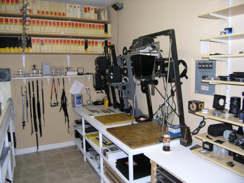

In 2001 I moved to Florida and built a new home. I put in what I thought would be a darkroom that would last me for a long time. Here's the wet side, 16 feet long:
The dryside/enlarger side:
I could print 20x24 archival prints and enlarge up to 5x7 negatives.

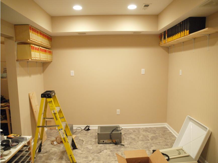

The new house had a room set aside in the basement for a darkroom but I never had time to build it (2nd tour to Iraq and commuting to a job in Florida). Two years ago I managed to get the enlarger room built out. I just retired and I'm focused on getting the darkroom built.

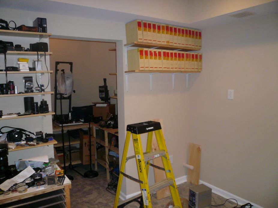

I sent the last two days building shelves to hold 130 or so Carousel 140 slide trays.
From the entarnce door:
The sink will be L shaped. The rear wall will be the film developing area and on the right side will be the print area. My goal is to have it done by Jan 15th.
This will be my 5th darkroom (not counting converted closets :smile: ) and hopefully my last. It will handle 20x24 archiveal prints and negatives up to 5x7".
As I make progress more photos will come.

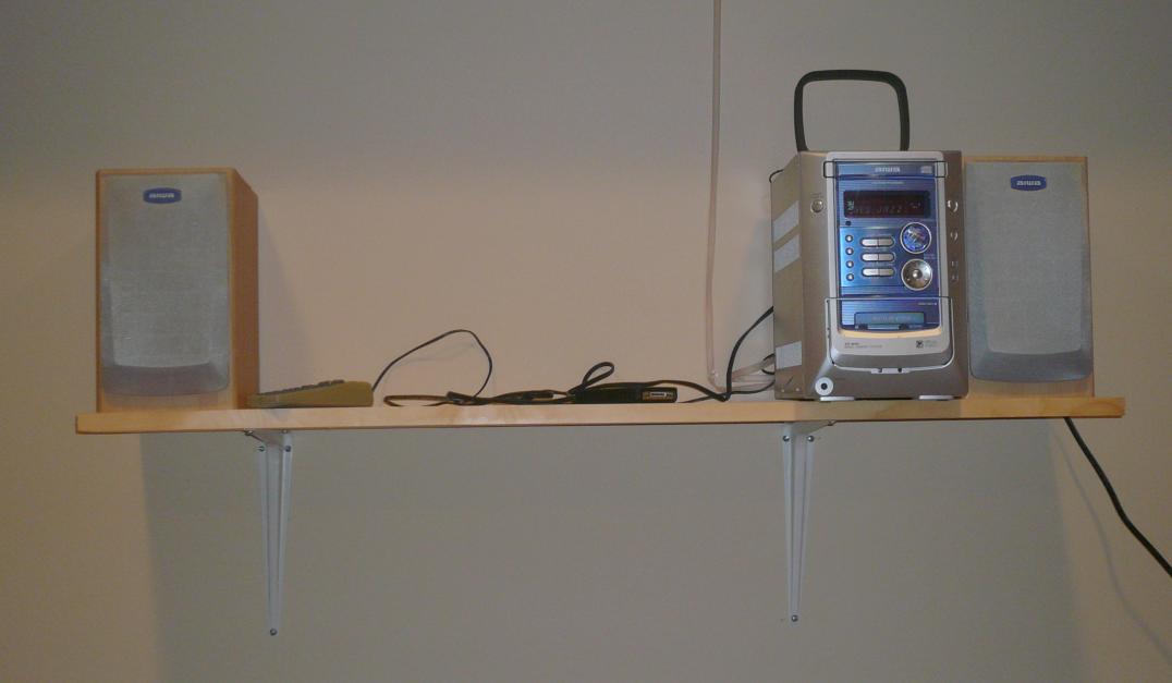

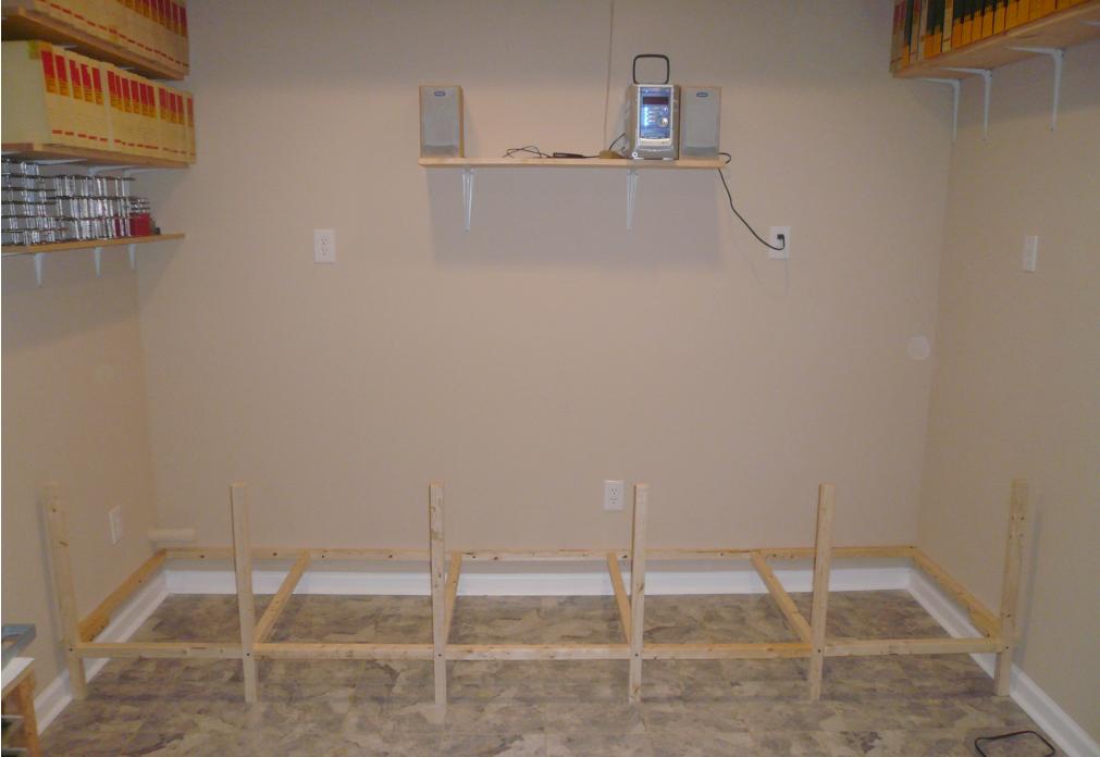

1. I put in a shelf to hold the stereo. It's a small Aiwa that has been the darkroom stereo for many years. FM reception is wonky so I plugged in my 240GB iPod. Yay! Much better working with music going. The speakers will be wall mounted once I figure out where the safelights & other shelves will be located. For now they are just resting on the shelf.

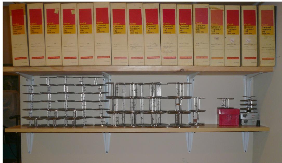

2. Put in the shelf to hold my SS developing reels - 35mm 120, 220, 127, and 110/16mm. I am missing a bunch of SS reels; they must be in my storage area. The 70mm reels go on a shelf under the sink. I have no idea where my 2.25"x3.25", 4x5, and 5x7 SS hangers are either :smile:. That 's the problem you encounter when you pack stuff up and put it in storage for 7 years.
3. Mapped the rear wall studs. The rear wall studs are on 24" centers (non-load bearing) but the side walls are 16" on center as they are load bearing. Having a map of where the studs are makes life so much easier when framing out the sink supports and putting up the back splash panels.

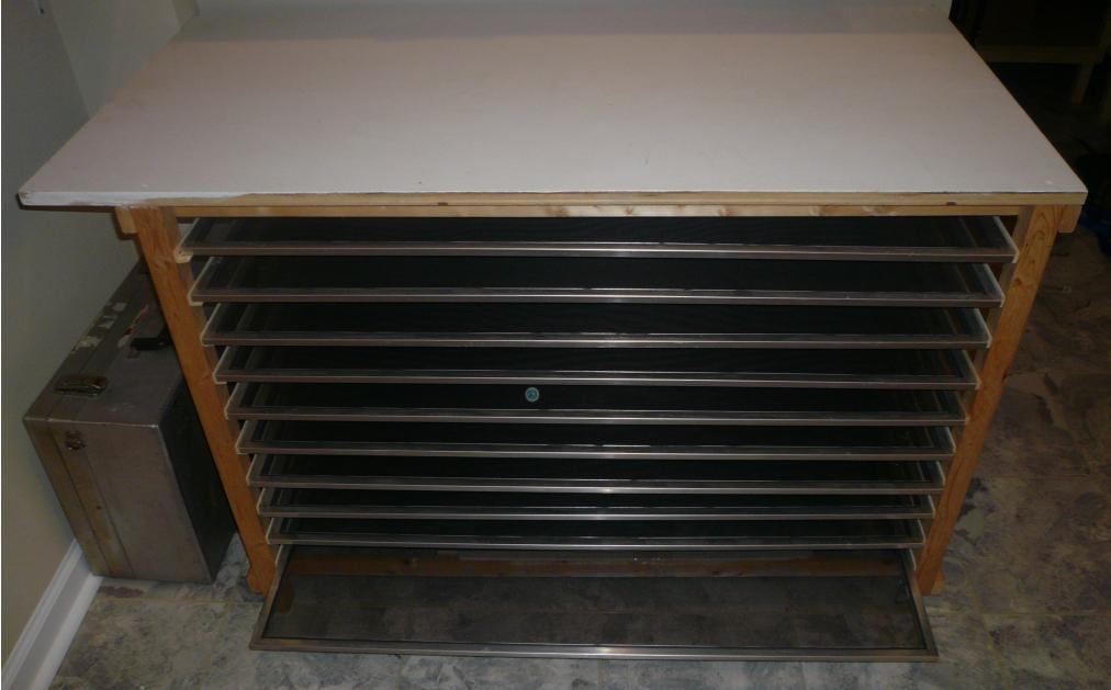

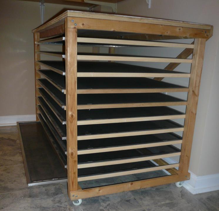

My print drying rack is on wheels. I bought ten 24x39" window screens (fiberglass) from Home Depot and put two casters on one end of it. I just lift up the other end and roll it where ever I need a temporary work space. It's light.
The top is a 2 x 4 foot piece of 3/4" plywood. I made the table 30.5" tall.
I used wood trim that has a 90 degree bend to make the rails to hold the screens - from Home Depot. A bit of paint and it's ready to roll.
The main room is 10 x 11.5 feet or 115 sq feet. The adjacent enlarger room is 10 x 4 feet or 40 sq feet. Total is about 155 sq feet.

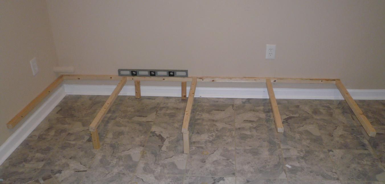

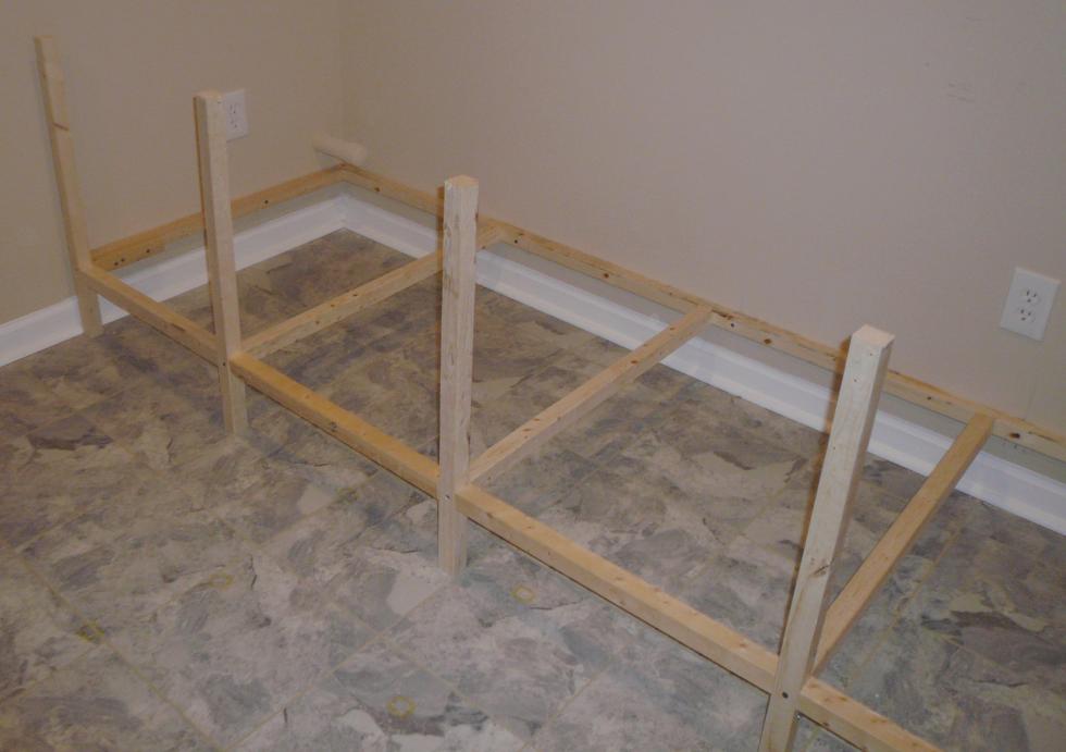

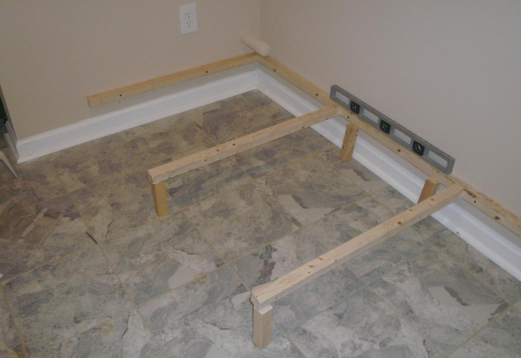

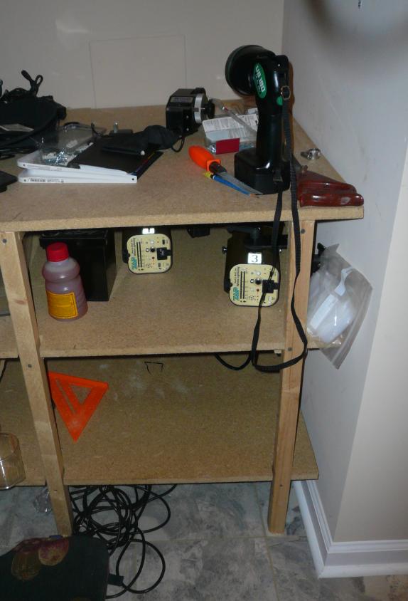

Made some progress today. Got the rear wall film sink support frame started. I used 2x2" x 8' lumber which are really 1.5" x 1.5" and 3" fine drywall screws. The cross members were screwed to the long wall rail then the entire unit was screwed to the wall.
The frame was positioned 6" above the floor. I cut four 6" 2x2 blocks that I use as spacers which helps getting things set up seeing that I am working alone. 6" clears the baseboards so you don't have to remove them.
The entire frame will be 30" high and the sinks will sit on them.

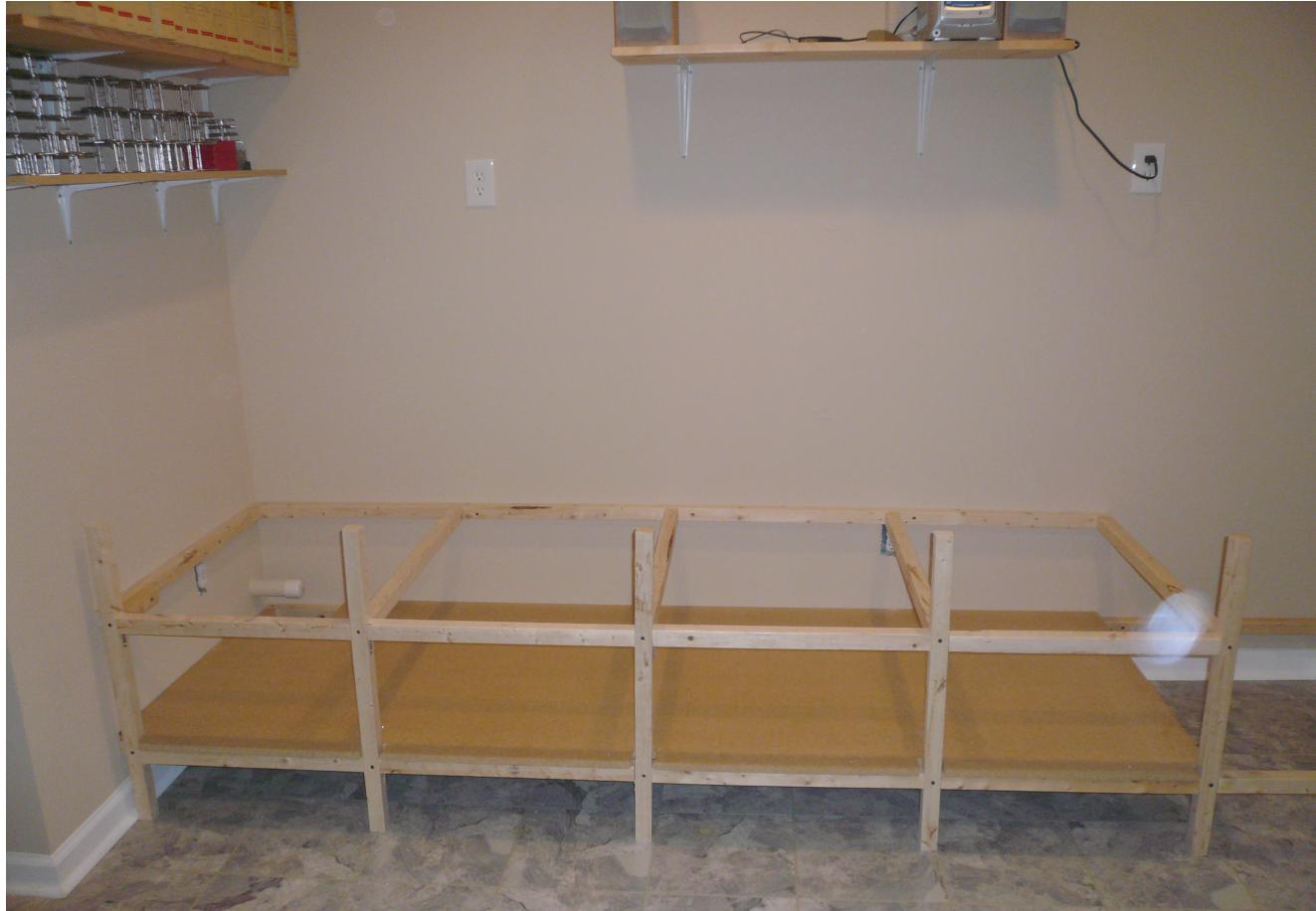

Next is to put in the bottom shelf. There will be a second shelf. The shelf will be made of 3/4" MDF board which will tie the entire frame together. The upright supports are 24" apart.
I'll get the shelf in tomorrow. The hardest part is getting started and getting the initial framing in. Things will go a bit faster now (I hope!).

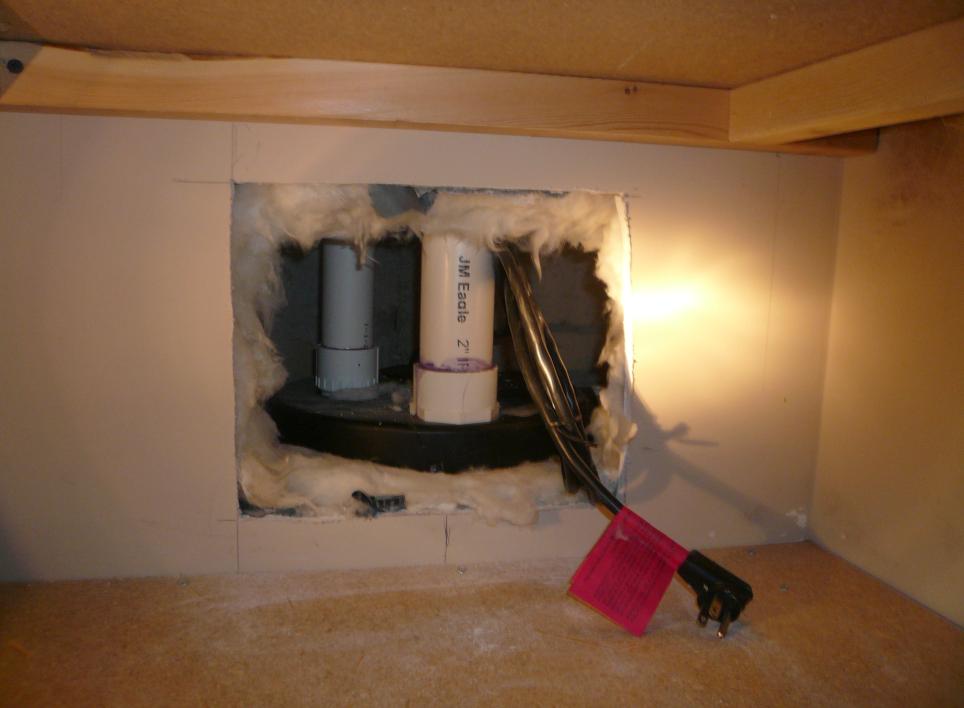

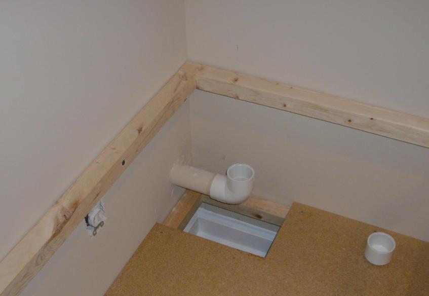

Ran into a big problem. The drain didn't work. In the rear left side of the main room is a 1.5" PVC drain pipe for my sinks:
It is connected to a sump pump on the other side of the wall. The pump is for a laundry tub that pumps the water UP to the sewer line that is overhead. I do not have an in-floor drain. The unit is a Franklin-Electric Drainosaur:
http://www.franklin-electric.com/li...aged-systems/13-hp/506065.aspx#Specifications
When we had our basement finished in 2009 the contractor installed the pump and it is totally enclosed behind drywall. It has it's own circuit with a 20 amp breaker. As I was out of state when the basement was finished I did not test the drain as the contractor had glued an end cap on it.
Now that I'm building the sinks, today I tested the sump. I decided to do it before I closed the drain area off with the second shelf. I'm ready to put in the 2nd sheld but doing so will make working on the drain hard.
I cut the end cap off and poured water in from a bucket. The sump filled up and did not pump. I checked the breaker - it was ON - and reset it. Nada. Crap. The pump is behind the wall in the enlarger room:
Yep, no easy access. So I crawled in by the bottom shelf and cut out an opening about 11x14" in the drywall to get access to the pump. After cutting away the insulation I could see the top of the pump. Sitting on top of the pump were the instructions! I could see the power cord so I grabbed to see where it went. Guess what? It was not plugged in!
I pulled the cord out through the hole I had cut and plugged it in. The pump works fine. I don't know where the dedicated circuit ends. I called the contractor and he is coming by Monday to sort it out.
I can't believe that they dry walled the pump in before they had finished wiring it up and left the instructions behind the wall as well. Mama Mia! :eek:
Now on to finish the sink frame.
Oi. And it got drywalled it in without access. Not a good idea. Every pump will need maintenance at some point.
